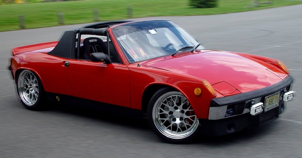

im with you champ im thinkin 18s also and these are what ive priced was thinkin 18x8 + 18x10 will have to severely modify guards
i know not much use in info but just encouragement (IMG:style_emoticons/default/beerchug.gif)
these may be close to 18

wasnt expecting any support. alright i gotta tell somebody; i fould 993 18" rims for 250$ i cant afford it but i think i have to do it. ones got curb rash but i dont care. i was looking at 700$ as a best price on 993 17's.
that car is sweet, cant tell if those are 18s or what, but now im reconsidering that style of flare again (IMG:style_emoticons/default/idea.gif)

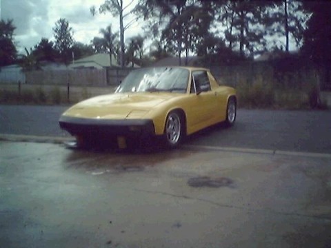

i have 16x7+16x8 as in pics but with the more rigid ride i could run a diffrent spring shock set up than most to retain a better ride or just put up with it i guess

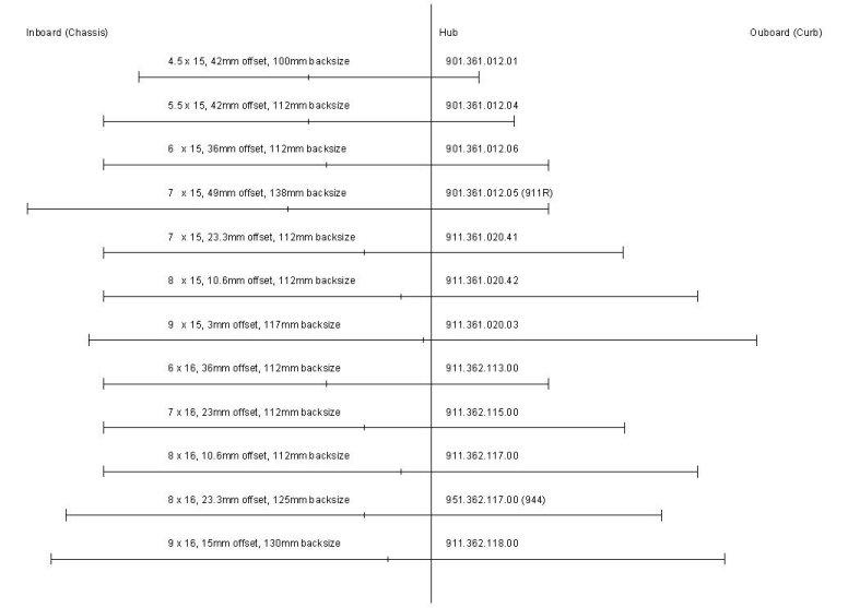

From: queensland, aus
Member No.: 4,293
Region Association: Australia and New Zealand
check on the forums here there is a wheel spacing chart ive seen it before or maybe some one has tried them

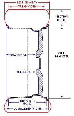

not sure but this was another diagram (might help)
