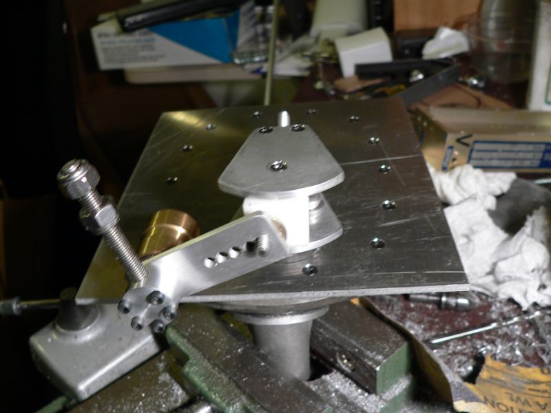

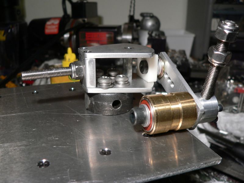

In this picture (my prototype shifter) you can see there are two threaded rods. These threaded rods are where the cable ends attach. The one in the distance at the top is for the rotational motion. If you pull or push that lever left or right it will rotate the shaft (which is going straight down through the aluminum plate into the transmission).
The other motion is accomplished by pushing or pulling the threaded rod that has the two nuts on it. If that is pushed left or right it forces the white plastic block to move up and down. That forces the selector to pull out or push into the transmission.
In the second picture you can see thethreaded rod that in the first picture is at the top, and kind of blurry.
Sorry for the SirAndy style photo (IMG:style_emoticons/default/smile.gif)
-Tony

So the brass bearing is supposed to be attached to the plate so that the movment is translated through to the delrin block?

Member No.: 166
QUOTE(mrdezyne @ Jun 21 2006, 09:47 AM) *
yes, exactly!
