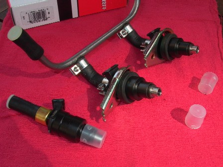

5. removed two fuel injectors. When I back-flushed, both had debris in the inlet screens. I blew them out with pressurized alcohol into a white coffee filter. One gave up a particle that looked like a fly sat there, and I'm not too worried about that. The second one had a piece of cured blue RTV about the size of an dry oatmeal flake, and paper thin. That one could be a big problem. (IMG:style_emoticons/default/ohmy.gif)
So I'm in the market for a set of 4 new fuel injectors. These were cleaned and calibrated at Marren FI in Connecticut. Only two are original- 95k miles old. One is about 40k miles old, and one is only 950 miles old. Time for a complete new matched set, in my opinion. Putting these in was like putting in a set of rebuilts...

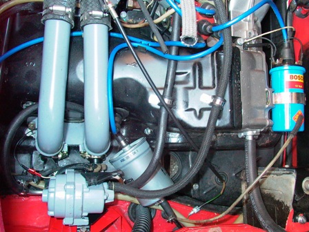

I replaced all four injectors with new ones. Took a chance on Niehoff injectors for MB 450SE. Couldn't resist them at $50 each-
Also added a modern EFI fuel filter. "Borrowed" the spare I had for my daughter's VW Cabrio. Happens to have 7mm inlet/outlet nipples-
Attached Image This is a temporary mounting location.
