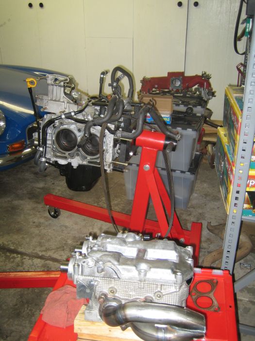

This is the engine that I started with, it came out of my daily driver STi that came to an untimely death:
When the timing belt broke 2 valves were bent so a teardown was necessary:

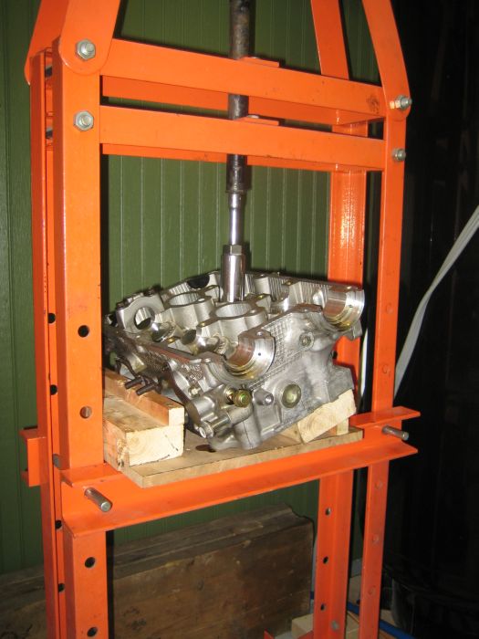

Due to the obscene cost of the Subaru tools to remove the valves I, made my own:
(IMG:http://www.914world.com/bbs2/uploads_offsite/www.digitaldash.org-4154-1328899179.2.jpg)

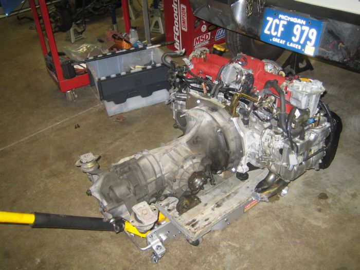

Put the engine back together and attached it to the trans:
(IMG:http://www.914world.com/bbs2/uploads_offsite/www.digitaldash.org-4154-1328899179.3.jpg)

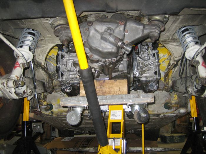

Slipped it into place and attached the trans mounts:
(IMG:http://www.914world.com/bbs2/uploads_offsite/www.digitaldash.org-4154-1328899179.4.jpg)

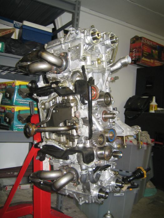

Here is a picture of the unmodified Small Car Performance engine brackets mounted to the bottom of the engine. They wrapped nicely around the oil pan. There was a slight interference between the water line from the oil/water cooler that required a notch.
(IMG:http://www.914world.com/bbs2/uploads_offsite/www.digitaldash.org-4154-1328899179.5.jpg)
