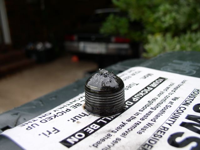

Allright, I picked up a big ol' 17mm allen key at Sears. I loosened the top first and second last as reccomended. Everything seems nice. I have two questions.
1. Is Castrol Hypoy C Gear oil in 85W-140 Okay? It says it is GL-5.
2. Look at my nasty bottom plug. It has a fair amount of metal on it.
(IMG:style_emoticons/default/headbang.gif)

Cap'n Krusty
post Aug 12 2006, 05:56 PM
Cap'n Krusty
Posts: 10,794
Joined: 24-June 04
From: Santa Maria, CA
Member No.: 2,246
The stuff on the drain plug is normal. Looks like it's been in there a while. The Cap'n

My transmission works fine--for the first 5-10 minute of driving. Then, as the car gets hotter, the gears get harder to find. Experts here said it might be time to add some fluid. I suspect that this car has never had its gear oil changed. I hope this helps!
I just cleaned off the plug and I laughed. I thought the thing must be dome shaped! Ha, it has a little magnetic rod in the middle. The entire dome was made of little bit of gears.

Joe Bob
post Aug 12 2006, 06:40 PM
Posts: 17,427
Joined: 24-December 02
From: Boulder CO
Member No.: 5
I've seen worse....my last tranny had a piece of second gear hangng off of it...
I'm a Swepco guy.....
