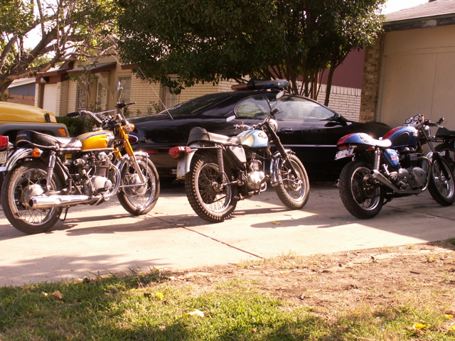

JPB- It looks like it's too late. I have apparently been infected with the 914 disease. (I think I always have been infected since my Pop taught me to drive in his back in the early 80's)
My wife will probably kill me as she deals with my 2 1970 BSA Scrambler Projects, 1 1969 Triumph Daytona project, 2 riding bikes (my '05 Triumph Thruxton and her '67 BSA) and 1 '79 Vespa scooter project... Now this!
I don't "need" six bikes do I? Maybe sell a few for 914 components...
Ahh well, she's probably used to it by now!

I'll take the Triumph...

I dig the BSA as well (blue & white)
