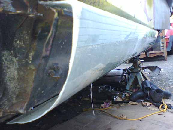

I built a form with polycarbonate sheet in wood:

It's hard to see with my camera phone pic, but the surface is near perfect.
on to the fender transitions...

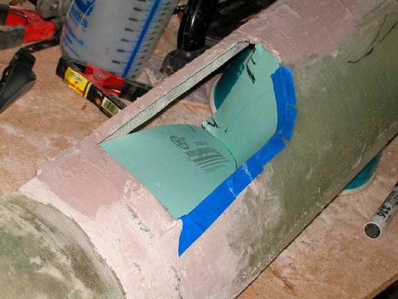

After fabricating the profile, I cut a separate length to extend to the fenders and then formed some wheel opening flanges. Since the fender was not straight, I had to fill the highs and fillet the lows to match the the gentle "S" curve. I fabricated plastic coated cardboard plugs for the fiberglass intercooler intakes and then bonded them in the rockers.

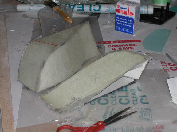

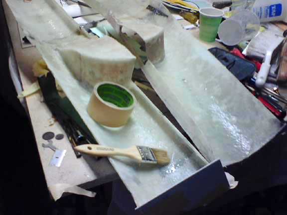

back tracking at bit:
I mocked up manila paper forms for the intercooler inlets
I made negative cardboard forms and coated with adhesive shelf paper, then layed up fiberglass cloth
