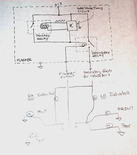

Basically, the flasher relay connects to +12v, and then ANYTHING that needs to blink is connected to the flasher's output, and turned on by grounding that specific item.
Turn signals get weird, though, because the circuit is designed to cause BOTH indicators to blink if an exterior bulb burns out. That's what is explained in the thread......

So I looked at your post (thanks btw) and saw your diagram below.
So, to verify, you have a 12V supplied wire (red wire, hot all the time), a ground wire (the brown one of course), then...
1. the black/grn/wht swirl has an intermittent 12V supplied by the relay? This makes sense to me... but do you agree it is intermittent 12V supplied back to the switch?
2. the blue/wht wire also has an intermittent 12V supplied by the relay?? This makes absolutely no sense to me and is the "circular thing" I mentioned earlier. Circular in that the indicator light has only two wires connected to it - either a blk/wht or blk/grn depending on L or R. THOSE WIRES WILL ALSO HAVE an intermittent 12V SUPPLIED TO THEM, right??? So that means the indicator light doesn't seem to have a ground, just 12v hitting it from both sides. The only ground I can figure out in that setup is at the flashing bulb. But current flow is the wrong direction and I can't see how that can work - I mean, it does apparently work but must be in a manner I don't understand.
Yes. You could call it intermittent. It's basically a square wave, but it's only there when a switch is turned on completing a path to ground, through a light bulb or bulbs. Could be directional signal, 4-way flasher, hand brake warning light, whatever. I have my "fasten seat belt" light as another user of this same "intermittent" 12V.
YOU'VE GOT IT!!! YOU'VE GOT IT!!! When a dash indicator bulb has the "intermittent" 12V supplied to BOTH sides, it just sits there dark. That's why the indicator light that FLASHES for the LEFT signal, is connected to the RIGHT circuit, and vice-versa. When the LEFT signal is on, the RIGHT bulb now gets the 12V square wave on both leads, and stays dark. The left bulb, however, sees the 12V square wave coming in through the blue/white wire, but the other lead is now grounded THROUGH THE FILAMENTS OF THE RIGHT DIRECTIONAL BULBS!!! (Pardon me for yelling.) This was done to provide an indication to the driver that a turn signal bulb had burned out. Reread my thread to see how this indication works.
The ground works, because each dash indicator is grounded through bulbs that are turned off. Namely, the left indicator is grounded through the right bulbs, and the right indicator is grounded through the left bulbs. Since the indicator bulb is so much smaller (much higher resistance) it turns on and limits current through the circuit (the other filaments) to a level well below what's needed for them to turn on.

That diagram another person put in your post, and your comment above about grounding through the other side, makes it all come together.
So you see why I was saying "there is no ground, 12V is supplied to both sides"?? I thought the left bulb got 12V from the blue wire AND from the blk/wht wire, which would essentially cancel out to me. Now that I see the right bulb gets hit with 12V from both sides so the right bulb gets cancelled out (doesn't flash) and the left bulb gets 12V from one side only (blu/wht) and grounded by passing through the whole freaking right light assembly.
What an epiphany. Cleverly over-thought - it is elegant in how it "indicates" errors as well, but goddamn is that difficult to follow. And just plain way to much thought for a car.
