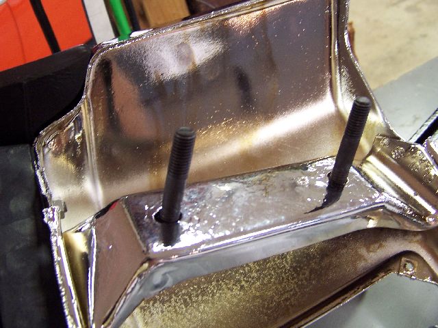

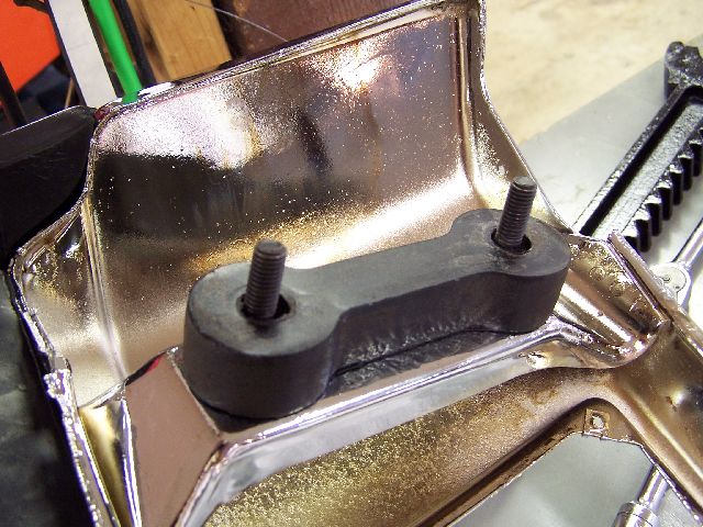

One thing that I always do is use threaded studs instead of bolts.
You put the studs in where the bolts are supposed to go and you can slide the dogbones over the studs, and slide them into the holes that you have drilled for them. This makes it a one person operation.
Note: you will use the dogbones for measuring the distance for the holes you will need to drill in the front and rear.
I will add a couple of pics for reference.
