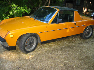

Natedog
post Nov 18 2003, 07:59 AM
Posts: 107
Joined: 20-October 03
From: Fort Collins, CO
Member No.: 1,265
Well I'll be damned!!!
I put some Marvel's Mystery Oil in the there and it's freed up!!
I can now freely turn the engine either direction!!
Is there an easier way to turn the engine than by grabbing the fan?
On my Squareback I can use a screwdriver on the fan because there are notches designed for that.
I must comment - Notches are cool, for sure. But I get a kick out of driving my Square here in Colorado. There are so many yuppie types driving the latest VW/Audi/Subaru/???? Sports Wagons!!! I love cruising past them in my 30 year old VW! All the while knowing that I built the car from the ground up, get better gas mileage, and paid about 1/10 the price!
Here's a picture of the 914. More pictures later....
Cheers,
Nate

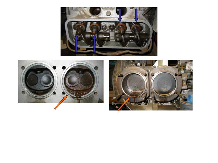

Natedog
post Nov 22 2003, 11:49 PM
Posts: 107
Member No.: 1,265
Hey all!
I've made it to the next step towards reviving my 914. The engine is out, all tin off, fan house off, heads and cylinders too! This is the most I have ever dismantled an engine! Always had a good one running I guess.
So it all looks pretty good except the #3 cylinder/head. There was water in the crankcase when I drained it and it looks like the water entered via #3! The inside of the cylinder was full of nasty brown sticky fluid - kinda chunky too. The insides of the crankcase look fine - as well as I can see in there! See picture below..............the blue arrows point to rust on the rocker arm assemeblies. The orange arrows point to the nasty ooze I found when I removed the head.
What do I do now!?!?!? (IMG:style_emoticons/default/blink.gif)
1. My inclination is to take the heads, cylinders and pistons to a machine shop for cleaning and inspection. If #3 needs to be replaced, can I replace only one of the cylinders?
2. How big of a deal is it that I had all that water in the crankcase? About 3-4 cups of water drained out of the bottom of the case when I removed the bolt.
3. Is there anything that I can do to the transmission as long as it is out? I have now idea what kind of condition it is in! I guess it looks well enough!
4. What parts MUST be replaced when the engine is torn down this far? What parts would be wise to replace? Seems like a good time to replace the piston rings, connecting rod seals, any other random gaskets????????????
My hope is that I can get all the parts that I've torn off the car cleaned up, refurbished, put back in the right place and get on the road!
Thanks in advance for your help!
Cheers,
Nate
73 914
73 Square
Fort Collins CO

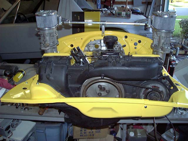

skline
post Nov 23 2003, 08:03 AM
Born to Drive
Posts: 7,910
Joined: 26-December 02
From: Costa Mesa, CA
Member No.: 17
Looks like you got yourself a 2.0 liter looking at the head. The best choice in the type 4 VW motors. Take the heads in and have them checked for cracks, it is common between the valves and at the spark plug. Easy fix though. Yes, you can replace just one P/C but since it has carbs already, you could upgrade to 96's or even bigger. The 96's just slip right in. While you got it apart, you could even upgrade the camshaft if it wasnt changed out with the carbs. FI cams are different than the carb cams. Good luck with it. They are way more fun than a type 3. And do not use a screw driver to turn the fan as the blades will break real easy. The maximum broken would be 3 fins and then they tell you to replace it. The fans are also different from engine to engine meaning a 1.7 will fit but the marks are different.
skline
post Nov 23 2003, 08:15 AM
Born to Drive
Posts: 7,910
Member No.: 17
Get a complete gasket set as you will use them at one point or another, you could just clean up what you have and replace the rings and run it. I found that if you want it to last, do not take shortcuts. Do it right and then you wont have to worry about it. At minimum, get the heads checked, clean everything up real good, replace the rings and cylinder and head gaskets and of course all the push rod tube seals and valve cover gaskets. Put it all back together and run it. However, with the water in the case, you have no way of knowing if the bearinds were submerged in water for the past 4 years. That I am sure would not do them any good. You have it this far, I would just do a total tear down and make sure. Do not have the case align bored like a type 1 or 2. They do not need it as they have the case through bolts they do not stretch like the others. If the PO put the carbs on, find out if he changed the cam. If he did not, it will run but not as well as it could. I would suggest at least a Web 86a cam to go with your carbs. Clean everything up on the outside also. I just did my engine and installed it yesterday in the car. I will be starting it up today. Here is a picture of my 2270 ready to be bolted in.

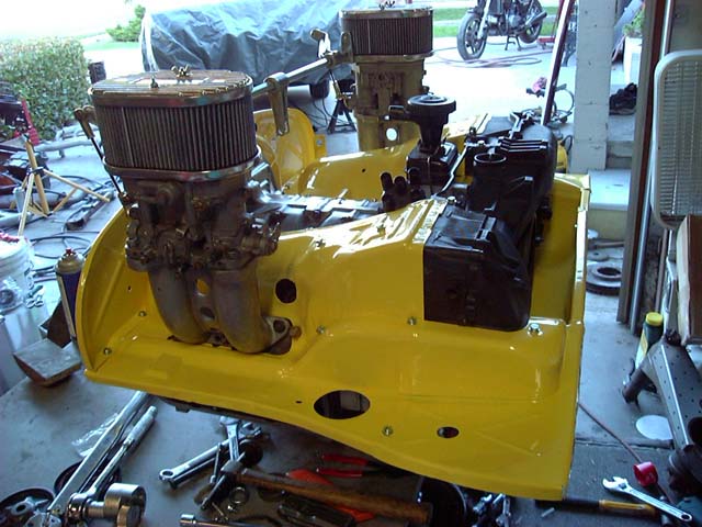

skline
post Nov 23 2003, 08:17 AM
Born to Drive
Posts: 7,910
Member No.: 17
Here is another from a different view.

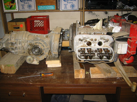

Natedog
post Nov 23 2003, 01:15 PM
Posts: 107
Member No.: 1,265
Man that's sweet! (IMG:style_emoticons/default/aktion035.gif)
I want one!!
Thanks alot for your advice!
I do indeed have a 2.0 with Weber 44 IDFs for carbs. Quick history....original FI setup busted and caught fire. New carbs installed....busted...caught fire. New, New carbs (the 44 IDFs) and it ran well for a few years. When the 44's went on the PO says he did a total rebuild(?).
Then it sat outside with a shotty tarp for 4 years.
I'll try to get some more specifics on what he did.
Where can I find some prices on the 96's that you suggested? I assume these are bigger cylinders/pistons. Would I have to upgrade the heads then too?
I won't turn the engine by the fan blades again, I promise. But how do you turn the engine when it is in the car?? On the bench is easy enough, but, for example, I'm still stumped on how I would turn the engine while doing a tune up!
What more can you suggest about the Web 86a cam??
My goals right now are to get it going on the cheap. But eventually look into racing it on a track!! I think it would be a blast!
Your engine looks FANTASTIC!!! What kind of paint did you use on the tin? I'll be painting mine orange to match the body.
Thanks again for your help and inspiration! I'm going to make a print of your engine for my shop wall
Attached is a general picture of the engine and tranny. Is there anything that I should do to the tranny?
