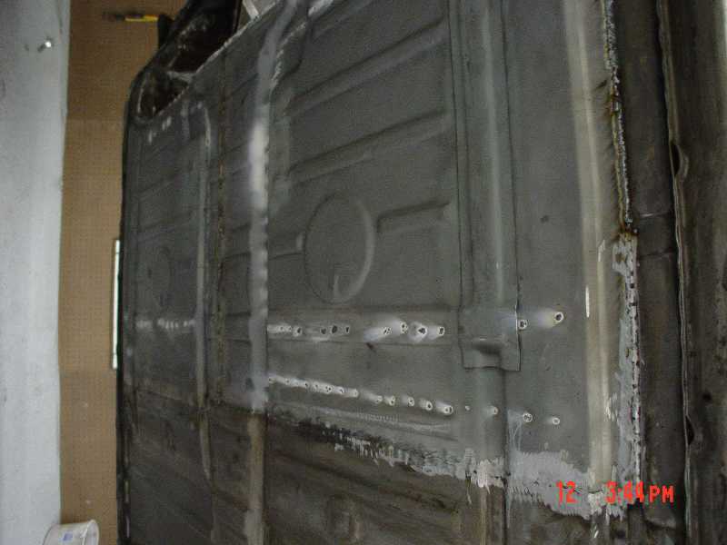

Well, I'm still picking away at this thing. I ended up removing the windshield and rear glass. Someone on this forum had posted a picture of a tool they made to remove the windshield trim so I made one and it worked very well.
I removed some rust,
made a patch,
and tried my hand at welding.
It came out ok, not bad for a neophyte.

Well, my attempts at welding have proved futile. I can't get these stupid spot welds to work. And if I can't weld, then I can't fix this rust bucket, so I guess this is now a parts car. Oh well, nothing ventured, nothing gained.
The motor runs and the tranny works. Any takers??

Cevan: You'll be able to do it. I learned how to weld mostly from reading past posts. The learning process can be frustrating, but it's necessary and in the end very gratifying. I myself was having a hell of a time until somebody pointed out that I had the wrong tip on my welder! (I was using a tip for flux-core instead of a tip for MIG). (IMG:style_emoticons/default/welder.gif) Just keep at it and don't feel like you have to finish it all in a couple of weekends. :-)

(IMG:style_emoticons/default/welder.gif) B-3 is my setting for MIG with my miller 175 (120 volt job) I BUTT weld all of it, trace the piece shape from the bottom, prop it in there and just weld spots 1" apart....keep going till its all done SPOT, SPOT SPOT SPOT worked great and only burned through a few times.......

Give us more info and we'll get your welder working right. Your patch looks great!

(IMG:style_emoticons/default/agree.gif) your prep work and patch looks great.. welding is easy once you get the hang of it ... I can stop by and see what the problem is... if the welder your using isn't up to it I'll bring mine over...

I appreciate the kind words but the patch is out b/c 1/2 the welds weren't really welds. It didn't take much to rip it out with pliers.
If I could just use some kind of epoxy, I'd be all set. The welder I'm borrowing a Solar. It has variable power and wire speed.

Only catch is that I spent 1k for my parts car, so you are already ahead! We can definitely help you get that car back on the road, keep asking questions. Does the welder you are using use shielding gas? Or are you using flux core wire? I highly suggest using shielding gas if you can. Also, is the welder infinitely variable with respect to power and wire speed? Either way, practice on some scrap, adjust the wire speed such that it isn't coming out so fast that you need to move very quickly to avoid pileup, and then adjust the power such that you are just starting to blow holes in the scrap. Then, back it off a little bit. I've had decent success using this method.
