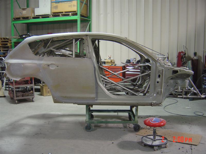

3= Yes a whole car can be coated I will be posting pics of a Mazda I am currently doing at wwerk that we coated the WHOLE inside of. Roll cage and all. Look for a thread by me with SEMA (IMG:style_emoticons/default/ph34r.gif) in the title. I'' attach a teaser pic for ya (IMG:style_emoticons/default/smile.gif)
