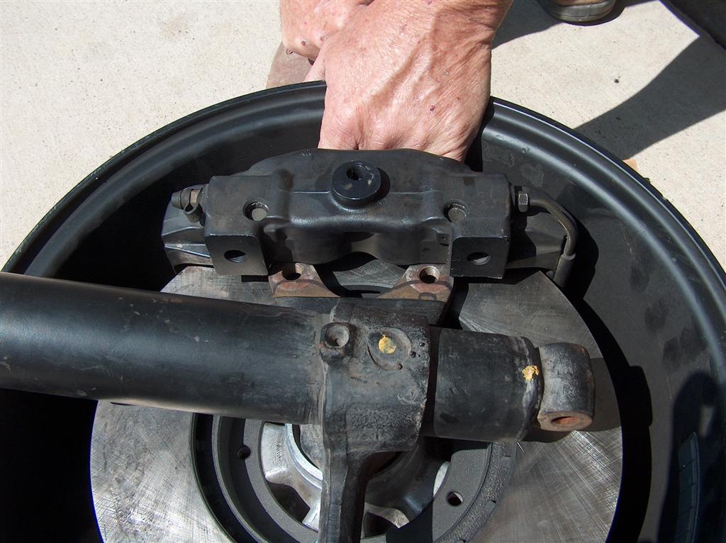

this pic should show how everything gets in the way (IMG:style_emoticons/default/smile.gif)
they fit under all 15" rims i own, cookies, fuch's, BBS 15x6, 7 and 8

Rich was the first guy i asked before mocking up the 3" setup above.., there is physically no room for an adapter on a 3" strut.... you have to mill off the ears, weld up a little thickness, mill it flat.. and THEN make an adapter.

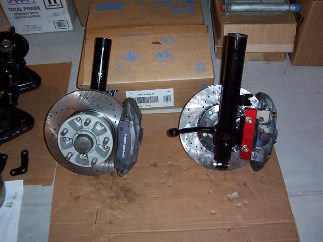

I have boge 3.5" spacing struts, with carrera rotors, non-s boxster calipers, and spacers all fits under a 15"wheel.

yep... that looks like the TRE kit. thats the bolt on approach...

With that pic even with the 3.5" spindle and the adapters the calipers are still not all the way in . Looks like they have a overhang to
