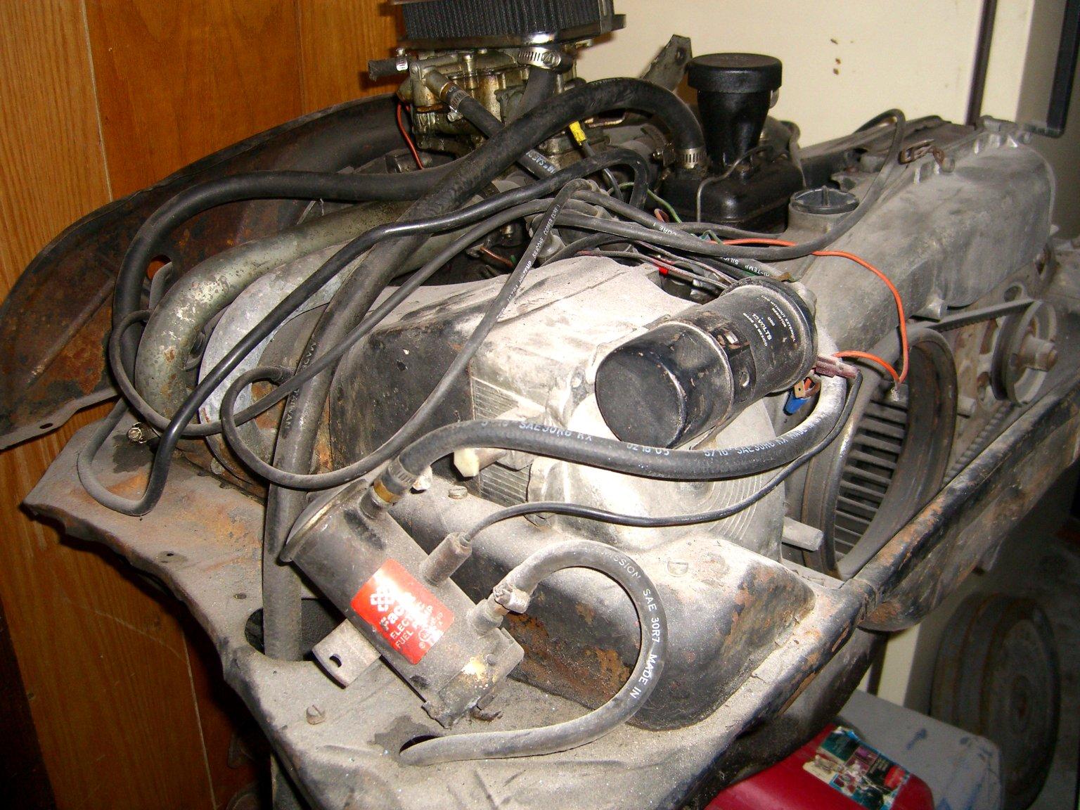

The motor has been converted to carbs, no original fuel injection included, no carb included. Not a lot of history. Unknowen if rebuild or origional. Motor pulled strong before it was removed though. Does have leakage on a couple of the push rod tubes but I would have resealed them before I put it in anyway. I have a set of Weber 40IDF's so the fuel injection missing is not a loss.
Looking at buying this just wanted some second opinions before I jump. I haven't kept up with the price of aircooled stuff as I had started down the Suby conversion path about 1.5years ago.

the engine mounting bar would make me think it s a 1.7L. if you can, check the engine serial number or at least, count the number of bolts/nuts on the intake to head runners.

Does this angle help. Can't see the heads but I know the plug location was different on the 2L's as well.

good point the second pic confirms that the spark plug angle is correct but I would certainly check the serial number ga or gb probably. (in front of the oil filler down in the canyon between that and the impellor. If a true 2.0 of questionable character 500 but no no more!!!!! We have hundreds of these questionble character 2.0 engines here and would be happy to get 500 for one, so maybe "low ball" the guy based on that.
