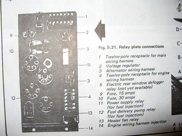

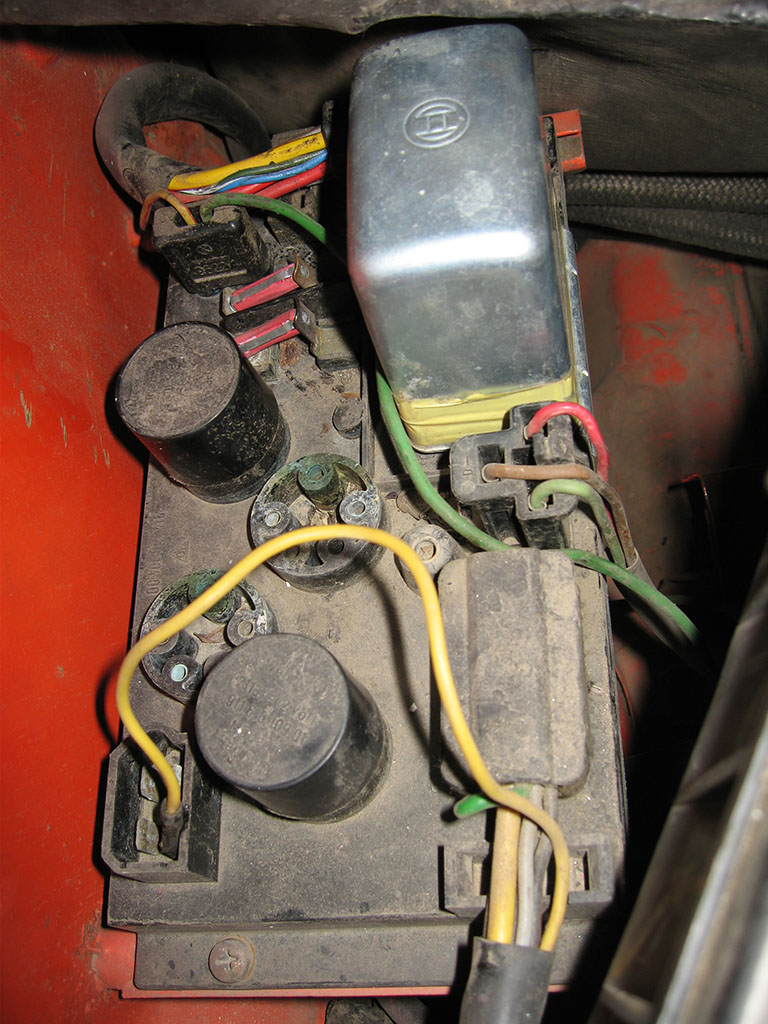

Thanks guys.. I think we're on the right track but I took a look and I'm confused now.
Here is a picture of my relay board. I'm also posting a picture of a picture a relay board from my Haynes manual to show what's what. Notice how both the power supply relay (for fuel injection) [#11] and the fuel delivery pump relay [#12] are missing? There's no way they could have fallen out.
The two fuses seem to be fine, although there are two 16A fuses instead of a 15 & 30.

Are you running carbs?
It would seem someone has wired your fuel pump separately. If that's the case you'll have to trace the wiring from the pump back to the power source. There's also the possibility that your fuel pump is failing, although I would bet on a wiring/connection problem.
