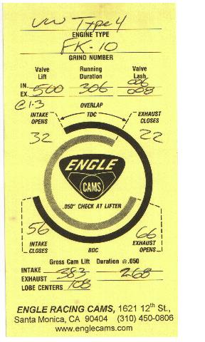

Andy, buy my cam:

We will use that cam in another engine later on Mikey. You have 100$ in it.. I think you will be ok.
B |

I'd rather have that $ in my pocket, but I'm sure another engine will be in the works if I have my way......speaking of money in my pocket, we just put our Antioch rental house up for sale, I can finally get my weekends back to myself (IMG:style_emoticons/default/smile.gif)
