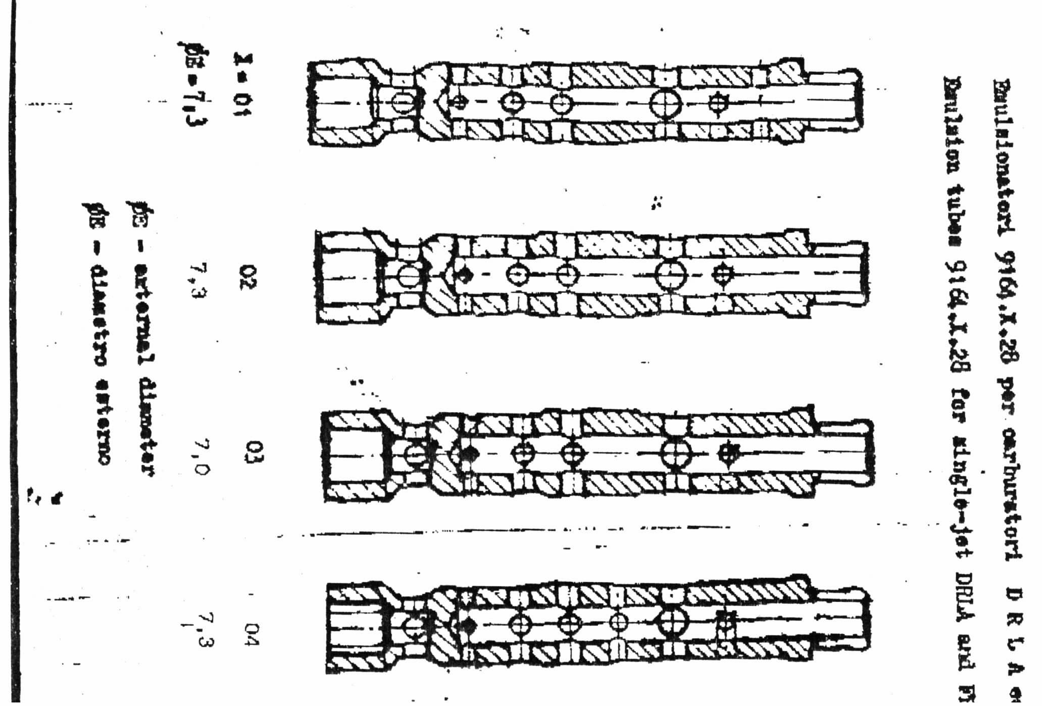

I've ordered some 185 and 200 airs, and have checked the emulsion tube. I have a 9164.1 tube, but the guy that sold them to me said "I drilled them out, so they are they same as the 9164.2". Does that sound right?

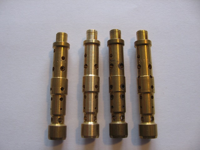

You can't "drill out" a .1 to a .2. You have to plug certain holes. I went through this ordeal with some poorly modded .1s that were supposed to mimic .2s. There are two upper holes you have to plug in order to get the .1s to be close to .2s. The raised middle band of the .2s is slightly larger than the .1s, but at 20+ dollars a piece, I'm getting by with the plugged .1s.
These pics should give you an idea about what has to be plugged. Hopefully whoever "drilled" them didn't actually drill them!

.1, .2, .3, .4
