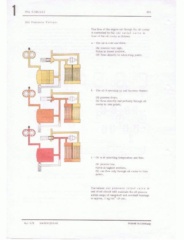

Here's the page from Porsche 914 manual about the oil system

I would guess that when the oil takes the shorter, less restrictive, that flow rate increases and the pressure from the pump decreases. If the oil took the longer path through the cooler, resistance would increase due to longer line length and the cooler core, the pump pressure would increase as the flow decreases. As the oil heats up and the viscosity drops, flow resitance drops, and pressure drops as the flow increases.
Pumps have a performance curve, pressure (head) versus flow. As flow drops pressure increases and as flow increases pressure drops.
I wonder if that's correct? (IMG:style_emoticons/default/idea.gif) (IMG:style_emoticons/default/laugh.gif)

John, you hit the nail on the head. Some thermostats have a pressure relief built into them. The Mocal does not. However, the console in the oil tank has a pressure relief valve in it at the filter. If my memory is correct, the Mocal when open is a direct flow so if the cooler plugs up your screwed....something's going to break......
