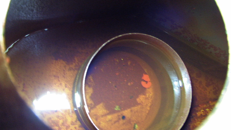

I'm taking care of the fuel system bit by bit; starting at the front and working my way back. I pulled the fuel tank and removed the facet shitpump and am replacing it with a CB rotary. I'm pretty much going the carbed route at the present time because FI costs so much. I guess it's just that I'm wary of carb setups because I've never tuned any carb larger than a .12 RC 2 stroke (which i was pretty damn good at)
I'm also cleaning the tank with that POR-15 stuff using the whole kit with marine clean, metal ready, and tank sealer.
I'll attach a pic of my fuel pickup as I bought the car.
The fuel filter was put in AFTER the pump....no wonder the pump jammed on loop 610. Yeah...I jammed an 'un-jammable' pump.

unless you removed it, you're missing the fuel sock/strainer that goes inside the tank on the outlet tube. the cb pump is the hot ticket. a stock fi fuel filter will serve you well.

That's just how I got the car...it didnt have a strainer sock....and the main feed line was PLUGGED with rust...the car was getting the fuel from the return hole, the one you can actually see. What I mean is that the tank was plumbed that way from the P.O.

no you're not. it's all part of the learning curve. the outlet is the one in the center. it sits in a slight depression for the crap to settle in. drawing fuel from the return tube is a direct path for the crap to plug the filter or ruin the pump. when you put fuel in the tank it stirs everything up. i chased plugged idle jets and filters forever until i fixed the REAL problem... the tank. had the carbs rebuilt. did the tank. put in one of chris folley's ss fuel lines. around 4k new miles on the odometer and haven't had a prob since.

Yeah rhody, that tank is pretty bad inside. I'm doing the marine clean thing right now and there is just SO much sediment looking stuff coming out. I will NOT re-plumb the system until the tank is sealed with that POR-15 stuff. I just wonder what tape to use to plug the top holes so the stuff doesnt run all over the place. I tried duct tape and the marine clean just lifts it right off. I'm going to try that aluminum 'speed' tape tonight when i hit the tank with marine clean again. After that...the metal ready. The tank looks SO bad inside, sheesh. You should see the sender before i brasso'd the outside of it, what a mess. This car is turning into a whole lot of work! If I could drive it I'd feel less overwhelmed. Hopefully I'll get the tank back in and drive it again this weekend.
