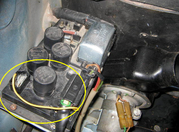

When I saw your relay board picture I noticed the yellow wire which made me think of my 1.8 motor with FI. Now I can see from your runners that you have carbs now but do you still have the double relay that is hidden below you battery box? If you do and it is still hooked-up it, it would be worth it to check the connections to it from the harness. Mine at one time had one of the spade connectors come loose and would intermittinlgy connect causing a direct short in my wiring harness...always frying the wire to the coil. It may be worth a quick look under there.
There is also the issue of your relay board...at one time you said you couldn't get the regulator out...do you have some sort of short going on in that board? Perhaps you could find someone who has a known good spare board that you could try.
