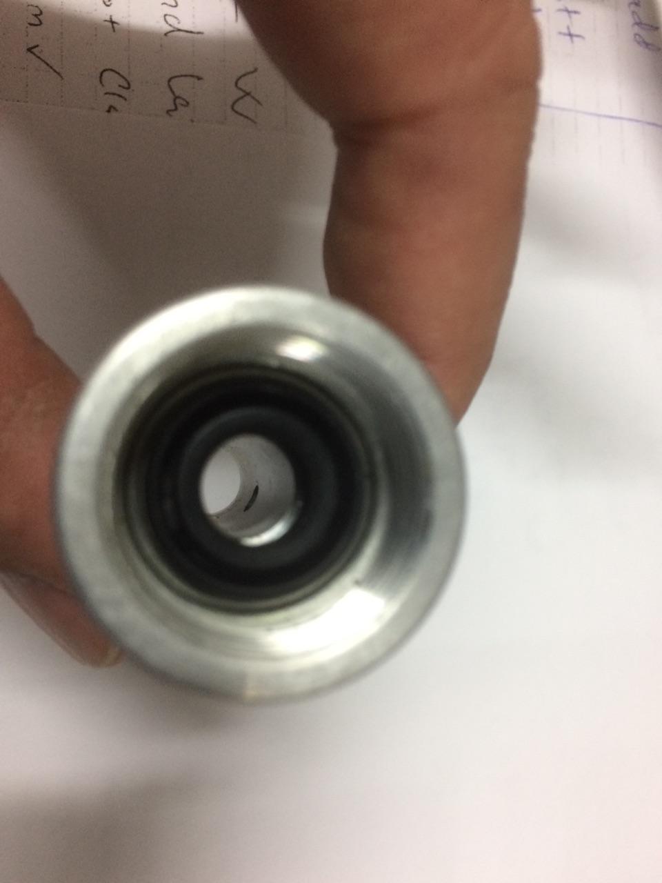

Which way does the radial sealing ring (999 113 036 50) supposed to be installed? I just picked one up from the dealer and notice the two sides are different. On one side I can see a spring.
Is the arrow pointing to the flat side with the spring on the other side?

I put the spring side inboard. Yes, that is the flat side, spring is farside.

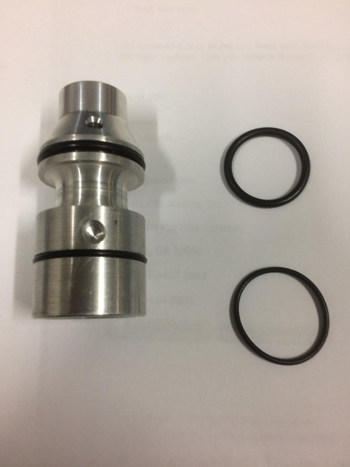

You may want to try this part to keep it from leaking. http://shop.914rubber.com/Speedo-Drive-Bus...2-901318243.htm

The "kit" we sell includes all but the aluminum washer. New internal seal, a second seal to help keep it from dripping and a complete new aluminum "bushing"
For $65 you get it all.
The dealership wants over $100 just for the bushing. This started as a rebuild service that McMark was doing and turned it into a outright purchase as we could bring the cost down and you aren't without a part you need (no downtime).
