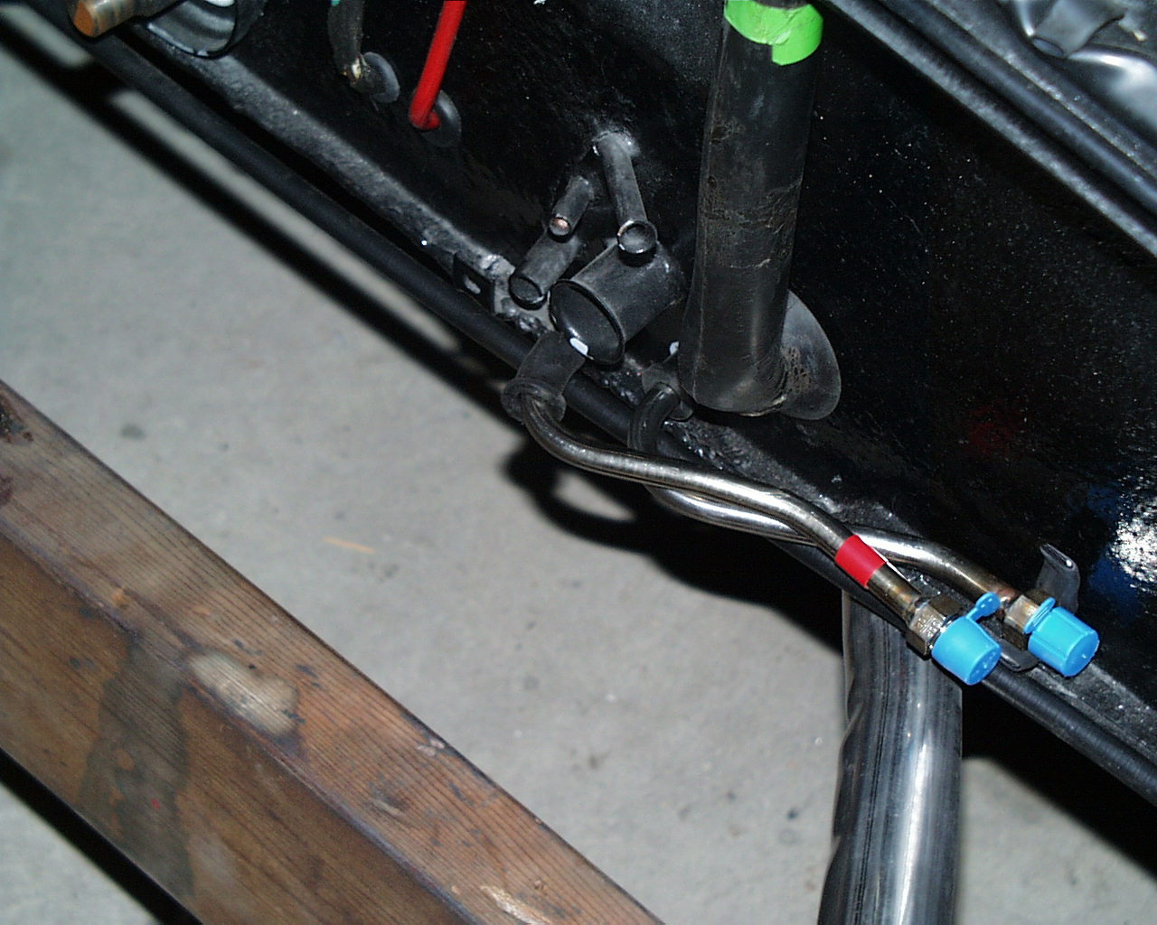

Here is a picture of mine. Sorry it's not a real close up, but I have a few more pictures somewhere in my BLOG.
SS fuel lines
