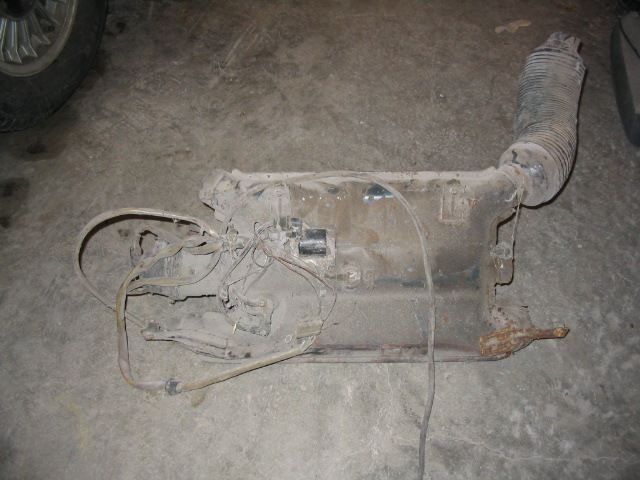

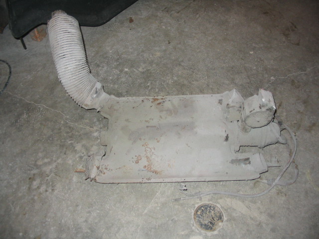

rick 918-S
post Dec 25 2003, 10:05 PM
Hey nice rack! -Celette
Posts: 21,018
From: Now in Superior WI
Member No.: 43
Want a gas heater? I pulled this out of a 411/412 many years ago. never used it, don't know if it works, don't want anything for it. Just pay the shipping.
