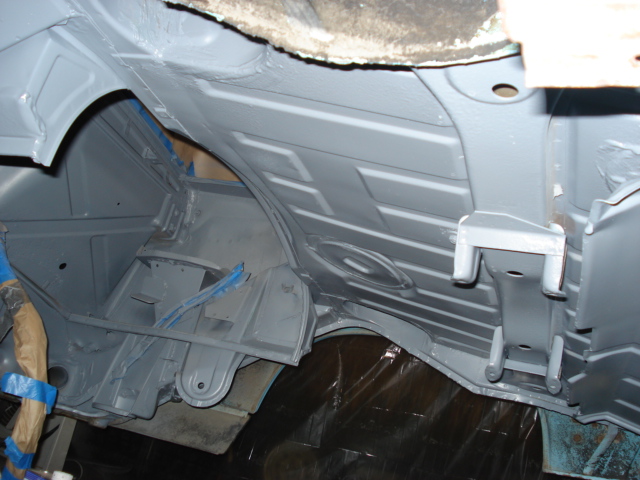

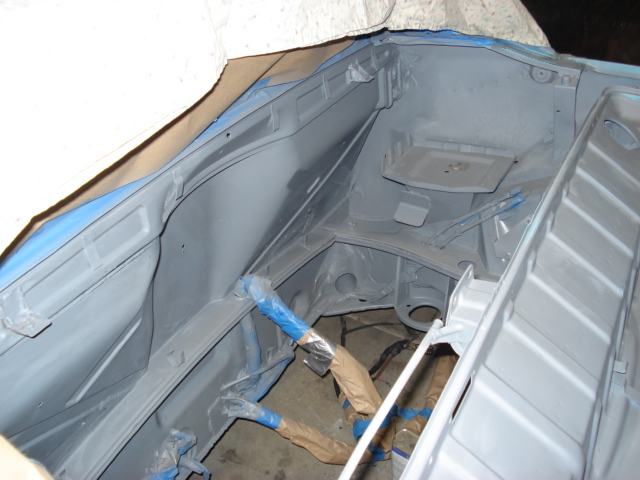

enigine bay and under trunk got primered Lotta work but it's worth it

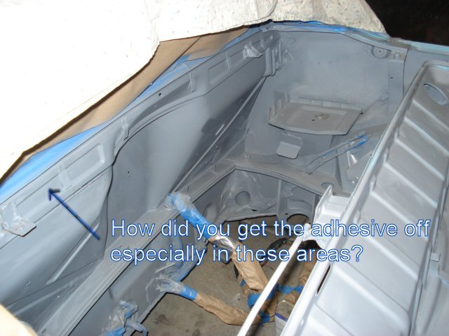

I'm prepping my engine compartment also and haven't had alot of luck getting the sound pad adhesive off. What did you use? Looks great!

QUOTE(kconway @ Sep 11 2007, 11:32 PM) *
Kev
Luckily, it was stripped by the PO.
There is adhiseve remover you can buy that works good. I used it on the inside, it takes some elbow grease but it will come off.
Kev
Go to your local body shop and see if you can get some of their adhesive remover. That is all I did, and it worked great at getting anything off that shouldn't be there. It also works great on cone scuffs.....so I've heard (IMG:style_emoticons/default/dry.gif)
