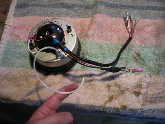

pic3 is a close up of the back of the oem tach- the connectors are labled as to what the wires on them do, so watch this when you take things appart, so you can re-connect to the leads off your new turbo tach

pic 5 shows the 2 fine leads off the turbo tach, red and black, for the high beam light. I needed to ground the black somewhere, I grounded it to the tach case w/the other wires being grounded there.

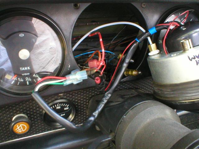

Now into the car. With the wires pulled off, and your old tach removed, there is a gole in the dash you need to fill. I needed to add a connector to the white w/blue stripe wire I cut (high beam light) to get the tach out. Added the connector, and ready to re-install.
Pics are a little out of order, but I'm a little to lazy to fix it-
pic 1- all wired up, vaccume/boost line connected, ready to install

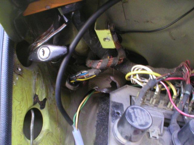

pic 2- when adding the SDS and wideband, I used a couple rubber fernco plumbing caps to cap off the heat tube in the rocker area, inserted some plastic hose, and used that as a conduit for wireing. I just pushed thru this plastic hose the small diameter boost line that came in the kit, and had my vaccume line from the back to the front. Added a "T" in the back, and was good to go.

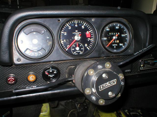

pic 3- tach in dash- looks good.

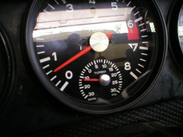

pic 4- close up of tach, it works!

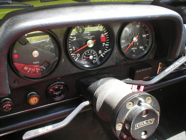

pic 5- replacment tach, this one with 15 psi boost gauge.
pic 6- out of order, but I added a stub line off the gauge and used a section of rubber to run from the gauge behind the dash to the line added in pic 2, to give myself plenty of length to work with.
So whats up with the 15 psi gauge? The initial gauge sent would only rev to 4300. Mark was ready to immediatly send a replacement unit, at his cost. I suggested we wait and see if the needle was just a little sticky. I went to Road America, and let one of the GRM guys drive it. A couple missed shifts and the needle had loosened up. But now it was bouncing all over at idle, compaired to the actual rpm shown on the SDS handheld. So more emails to Mark, and he shot me off another turbo tach. I asked him if 15psi was an option, as that would be more suited to the car, he said "sure!" Didn't once even imply that I was looking to get the tach re-build because of that. I never thought to ask about 15psi when ordering.
