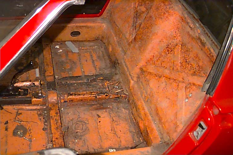

here's kind of where i basically started:

After some "cleanup"

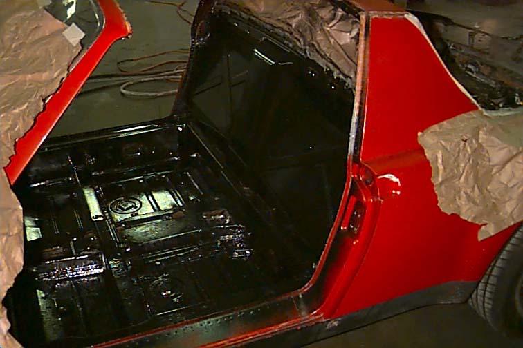

Pictures I found when scouring the Classics:
Is mine comparable to this? or was his surface rust?

is it rusted through, that is, do you see the road thru any holes? if not, why not wire brush the rust away and POR 15? if so, you can drill the welds and weld in new floor pieces. restoration-design, among others, sells floors.

Now I've pretty much read EVERY thread in the classics forum about floorpans. Depending on ya'lls recommendations, im leaning towards
Restoration Desigins floorpans, or if i can find the Left and Right combination id prefer that
Let me know where i stand on this project.
And just to nip it in the bud, please don't say this is a "parts" car.. because the only thing it's a part of is ME. (corny i know, but the parts car comments get to me..)
thanks for your help!
stateofidleness
post Sep 23 2007, 02:25 PM
Posts: 810
Joined: 1-September 07
From: Canyon Lake, Texas!
Member No.: 8,065
Type, it is rusted through in SOME spots but not all over. Mainly in the corners.
Id like to do this the right way the first time so im leaning towards getting new pans. Would it be safe to go ahead and order them?
where can i get the left side/ride side combo as opposed to back and front pans? or what is recommended or easier to replace?
ive tried wiring brushing it and it looks fine but since theres random holes and a big one by the pedal assembly corner, i figured i might as well just replace the pan with a new one and start from scratch.. that way i know what im sitting on. also i could then add the stiffening kit

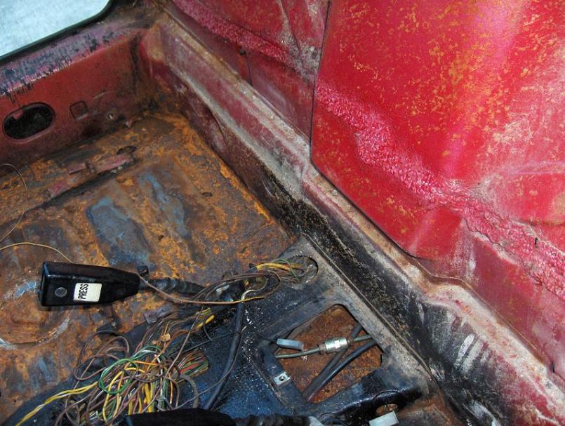

so i decided to just.. "dig in"! here's where i stopped for the day
I found $0.12, the broken handle for the seat adjustment, and one of the screw things for the headlight motor!!! woohoo

914 and stateofidleness are mutually exclusive! (IMG:style_emoticons/default/biggrin.gif) As mentioned above you need to have a really good look around at the longs as long as they are ok then you are good to go. Do you weld?

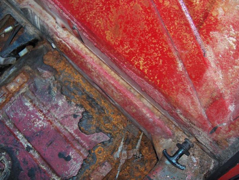

heck - that ain't rust! You're good to go!
how about shots of the two rear corners of the floor and the rust through

under the seats? or near the pedals?

Peel up all of the tar crap in the floor boards and then look at the whole picture. Take a four in grinder and put a knotted wire wheel on there and go to town. It will take most of the rust off. Then Por-15 or Marhyde One Step the whole thing. Take the sound pad off the firewall and look for rust there and at the base of the fire wall. I am betting the rear window is leaking and needs to be resealed. Also look at the point where the firewall connects to the floor pans. Those are good places for the water to hang out and start rusting.
