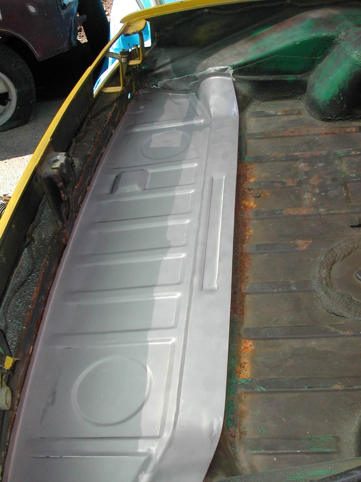

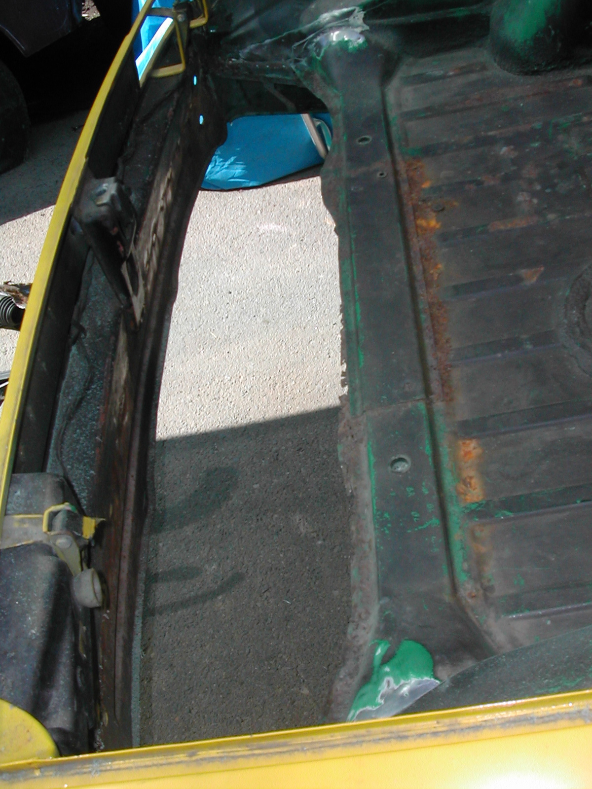

Well, I've done some research on this site, but need some more information. I'm planning to replace the rear trunk floor and noticed McMark's comments on this post.
Here's what McMark suggested for replacing the trunk floor...
In this picture I'm assuming that McMark cut the existing floor pan just in front of the center structure, then spot welded the replacement on top, like this?
Also, I'm assuming that the sides and the rear section are spot welded to the sides, correct?
Finally, my car has the original factory rear sway bars, I'm assuming I need to remove the sway bars, but how do I remove and reinstall the upper piece that is welded to the floor?

We drill the spot welds out of the reinforcement so we can put the floor under it and hide most of the welding. Makes a better repair. The latest trunk floors go plenty far forward enough to accomplish this almost invisible repair. We also spot weld the lip around the perimeter and use the wurth seam sealer in the wurth application gun to exactly duplicate the factory motley finish. Ends up looking perfect! (remember that the muffler shield is welded to the pan underneath and on the sixes bolted.

I cut out the rear trunk piece just like you did. Right behind the spot weld flange on the cross member and then seam welded the replacement piece in and ground the welds smooth. There is no overlapping metal in my repair. That car had no sway bar, but I did have to drill out the spot welds for the tow bracket (you can see it in your picture). That was a PITA. The sides of the replacement pieces are flanged upwards, so you can completely remove the old part and tack weld it to the sides/rear of the trunk.
In your case, you could think about leaving the corners in place (just like you have now) and cutting the sides off the replacement metal. It will save you a lot of time, and would be perfectly acceptable if you're ready to butt weld the pieces together.
If you want to replace the whole piece, you can drill out the spot welds for the tow hook, drill out the welds for the sway bar top brace (flat metal pictured), drill/grind the welds for the sway bar bracket, then remove the rest of the trunk metal. Then weld the new trunk in and then weld all of the bits back on to it. If you did this, buying a new sway bar brace (the flat piece) from Engman would be a good idea, because that piece will probably die when you remove it. (IMG:style_emoticons/default/wink.gif)

usually we trim this to fit under the reinforcement and seam it there. Our nice piece that we make is shown in the picture. We made it that way for the bad cases when the floor would be rusted in front of the reinforcement. Again welding under the reinforcement is the best way. The pictures show an immaculate job, but they also show the replacement in the worst case scenario.

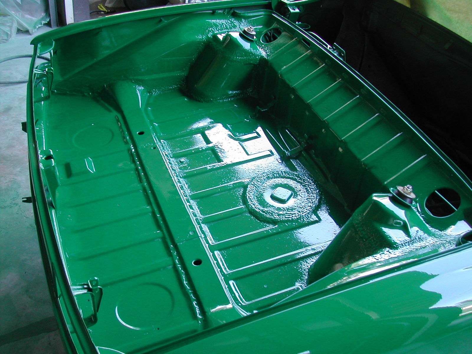

Don't remove good metal just because it's part of the replacement piece. The stamping from Restoration Design is not a recommended fix, it's just a piece of metal that covers a lot of territory. Just cut what you need and don't make more work for yourself by removing the cross member top. (IMG:style_emoticons/default/wink.gif)

Mark, I'm definately going to only cut out the sections that are bad. I'll post pics tomorrow showing how I fit the new piece. I've already cut out the passenger's side corner, but I left the metal where the sway bar bracket is welded. I'll be extra careful when I weld in the new piece. I agree, I'm not going to remove the cross member. I noticed that if I removed the cross member, I would still need to butt-weld the new piece beyond, so I've decided to do the butt-welding before it. Pics tomorrow will better show what I'm trying to describe...
George, this is the only pics I found on your web site showing the rear trunk floor replacement. It appears that there is a weld in front of the cross member, going the whole length of the replacement piece.

Those are my pics of my dads trunk. I did go that far only because I knew there was rust in the suport and I wanted to take care of it. By welding the complete panel in I am having to weld over all of the strengthening ribs, then grind all of that down and at the same time get it smooth enough not to be obvious. I would not recommend this way for most people. Taint for the faint.......

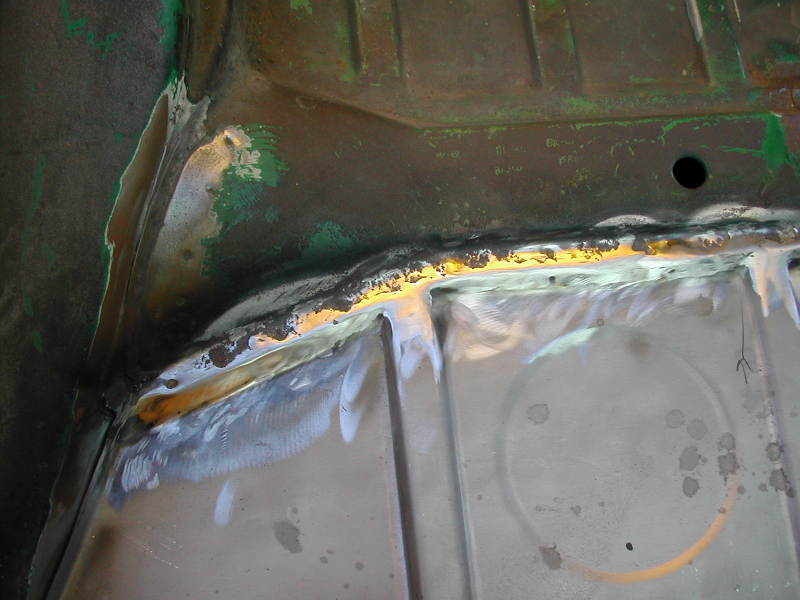

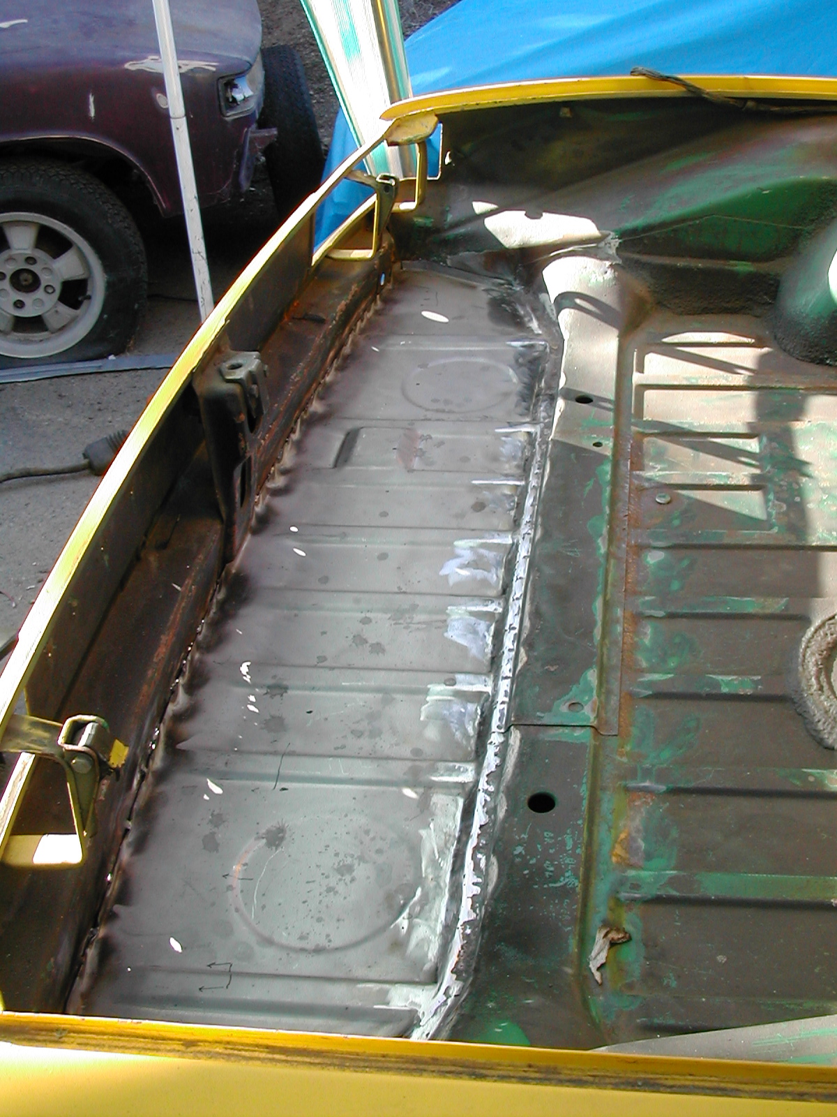

Well, I've spent the entire weekend installing the rear trunk floor. Saturday I cleaned the dirt and grease underneath the car. I also decided to cut out the passenger's side corner, but left the factory installed sway bar bracket. I was also able to cut the replacement panel, trim and tack it into place.
Sunday I spent the entier day butt-welding the side nearest to the cross member and seam welding the sides and back section. I still have to add the seam sealer, then prime and paint...
Thanks again for everyone's suggestions...
Here's where I cut around the factory sway bar bracket...
Here's the floor welded into place...
Here's a shot of the floor welded to the factory sway bar bracket...
