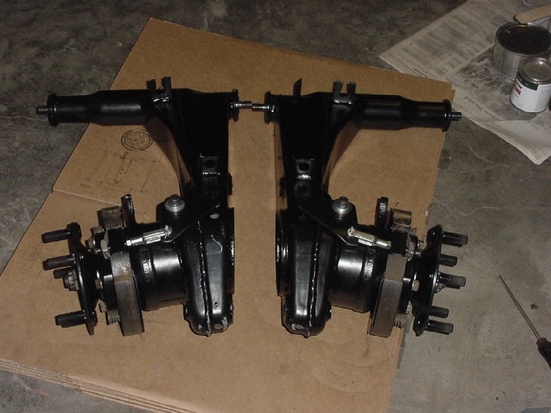

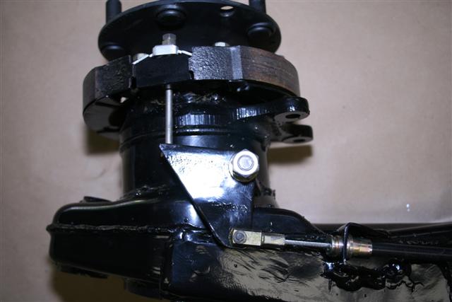

I traced all of the parts i made and was going to send them to Aaron but have misplaced them. I may take it apart to clean up the paint over-spray from the paint job on my car that got on the control arms. If I cant find the other tracing i will retrace the parts again.

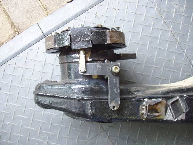

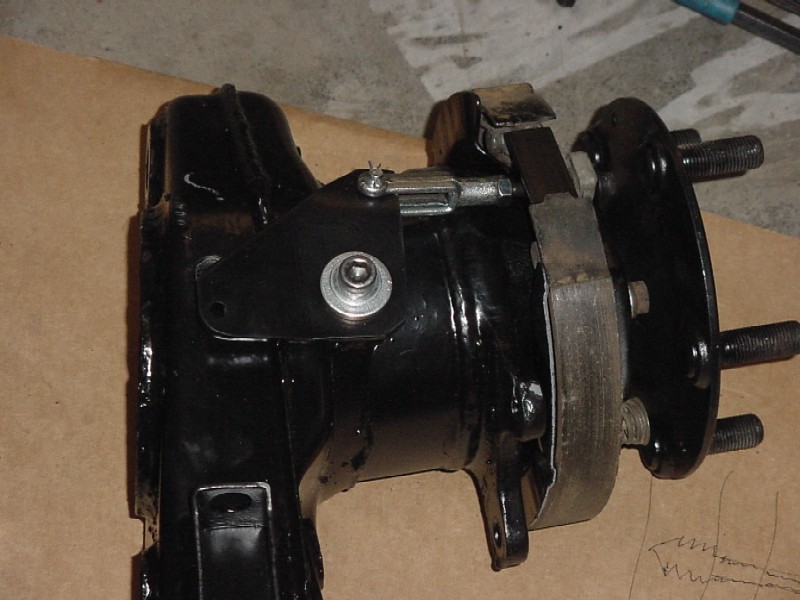

I would have to go measure mine to tell you the dimensions of my belcrank arms, but I believe that they are approximately 2" from the pivot.
Like Aaron mentioned, you could make a ratio out of the crank arm to minimize the e-brake lever travel, but mine are 1:1.
So Rich Johnson makes a kit for this? Maybe we should "oust" the ripoff (just kidding). If Rich makes a kit, I'm sure it is a good one, but I made mine myself. You could also do a web search for Phoenixhobbies.com

Iamchappy and John thanks for the pics. Iamchappy if you could give me the measurements I would really appreciate it. A template even better. Your pic clears up one question I had, I see how you built up the pivot point mount I was confused on that. And what are you guys useing for the link/rod assy to the ebrake butterfly actuater? I love this forum.

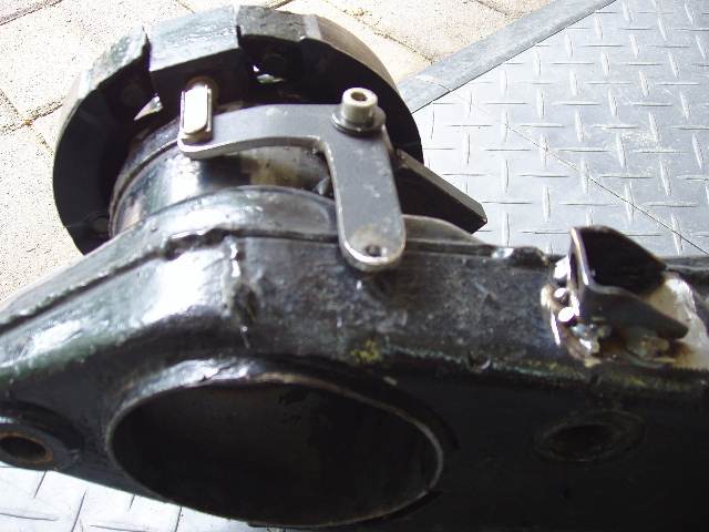

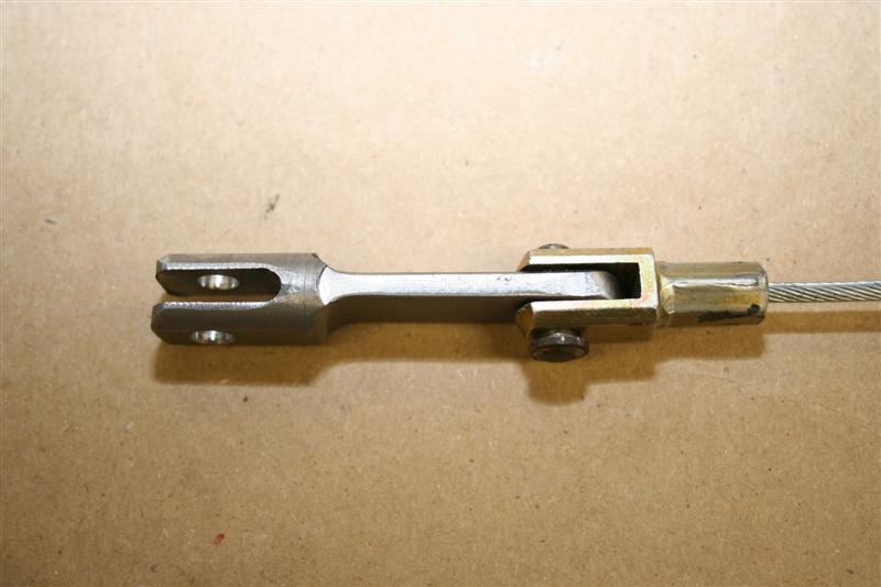

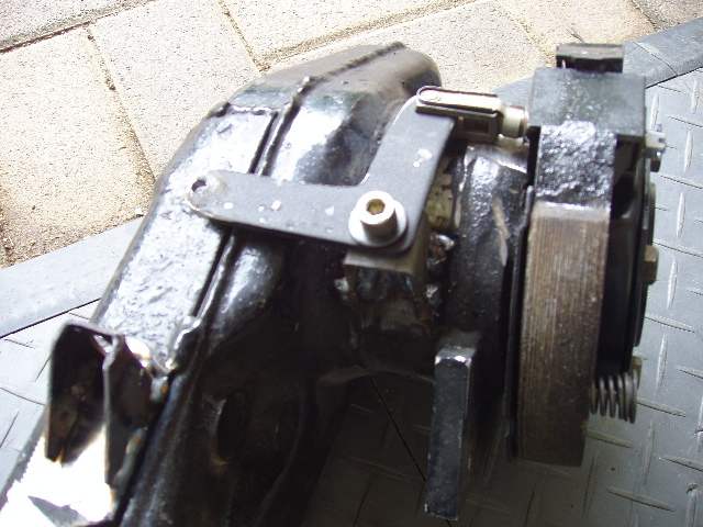

I used forged clevises from McMaster Carr and 1/4-28 socked head cap screws with jam nuts (for the adjustment). I also used male spherical washers under the heads of the fasteners (where they seat against the bow-ties) for any mis-alignment. I have been using them for more than a year now with no issues (after the initial adjustments).
I can look up part numbers if it would help you.
Once upon a time, I looked at "kits" but they would have been more money than I thought the typical CSOB would pay so I never made any "kits".
Good luck with your project.
iamchappy
post Oct 1 2007, 09:28 PM
It all happens so fast!
Posts: 4,893
Joined: 5-November 03
From: minnetonka, mn
Member No.: 1,315

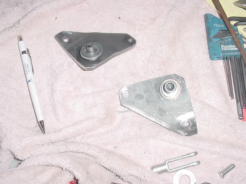

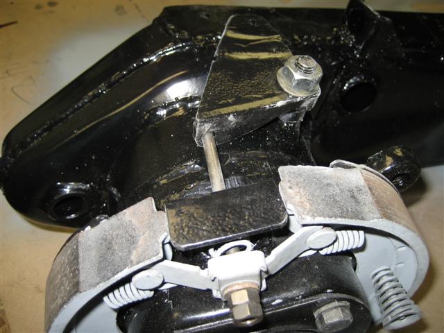

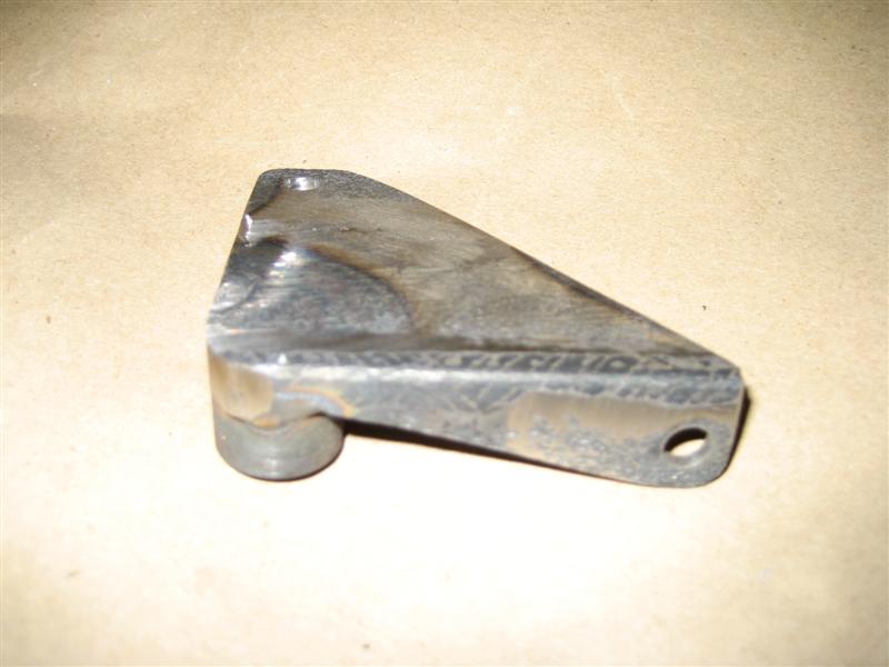

I used i believe a 6mm threaded rod or whatever the clevis tapped for, i have a small castlated nut and washer and drilled a hole for a tiny cotterpin.
I measured the placement of all the brackets with the cables in place. My bellcrank arms are a little longer than some of the others ive seen so i could use the stock cables without extensions.
If you look at the bearing end you can see the needle bearing shaft pressed into place.
The brake caliper mount is for 951 brakes.

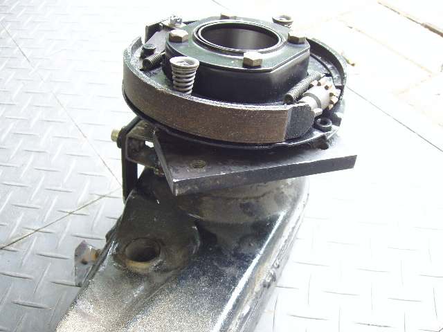

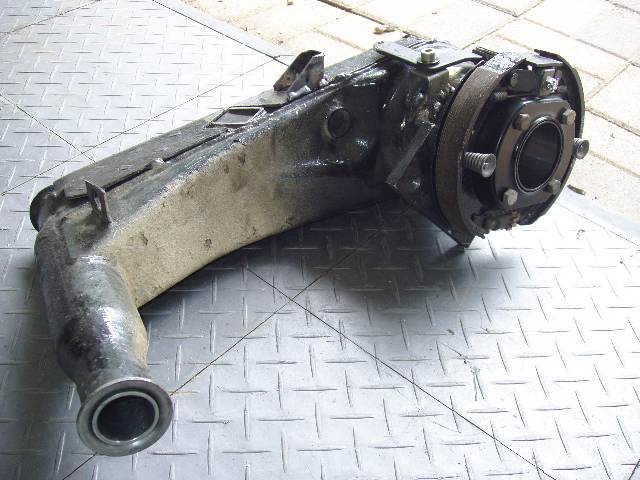

Here are a couple other pictures
John

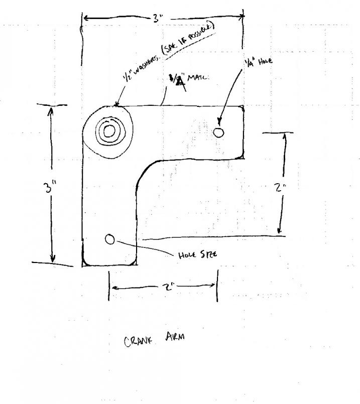

Here is the sketch that I made before changing them into triangular shapes.

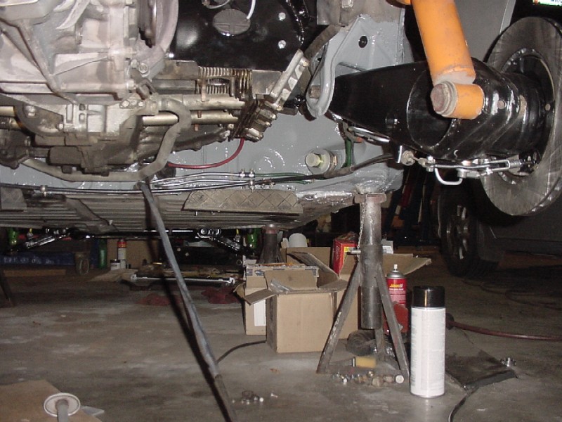

I did mine similar to John's. I moved the left side cable restraint back 1 1/2" and made an extension for the inner cable. As John originally pointed out, the cable will pull tight on the left side during suspension movement if it is not addressed like this or some other method to gain a little slack.

I use an oil bronze bushing as my pivot. I think design may have something to do with other bell crank setups not working properly. My pull is straight and short, I dont see any problems with binding but we will see...
I did consider the cable sheath design but didnt like the idea of the cables making that big U turn under the exhaust. A motorcycle throttle cable sheath with a 90 degree bend in the sheath maybe the cable answer to that.
