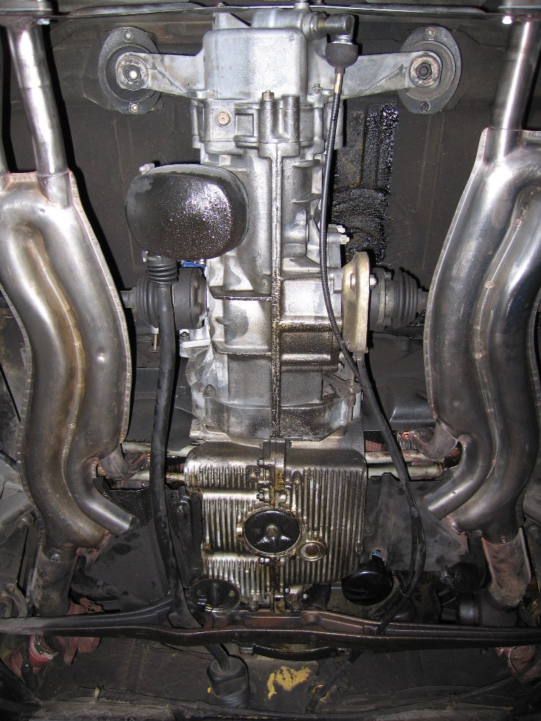

Wow great feedback. As far as I know they did replace the gaskets. I have to assume they did ~ I provided them, and I told them I wanted to keep the old hardware they pulled off (to make sure they didn't reuse what was already on there). When I showed up, my stock HEs were sitting there along with a box of nuts and the old gaskets. I do believe the new ones are on there.
So, my car does leak oil (can you believe that?). The theories posted here about oil being the issue, while possible, don't account for the subtle backfire that accompanies the exhaust smell. Occam's razor ~ I think the two are related. And since an exhuast leak would cause both, that's seeming like the most likely problem. Had I known that they were so difficult to fit, I would have at least warned the guy. Hmm. I think I'll call him and see what he says. Maybe they'll re-fit them for free (yeah right).
Here're a couple pics. See anything interesting/disturbing? Let me know. (IMG:style_emoticons/default/biggrin.gif)

Another. First time I've had my car on a lift, pretty cool to see.

Last one

Noticed that your muffler bracket is different than mine. Mine goes to the rear of the muffler instead of in front like yours. I went down to see Dave at Triad several months ago and he did some work on my bracket to make it fit closer to the bolts, was almost like it was a little short in width. He seemed to think it was OK the way it was. I guess I got lucky with mine, no leaks and no popping. You might want to call Dave and see if he has some ideas. The number on his web site is still good, at least it was a few weeks ago.
Tom
