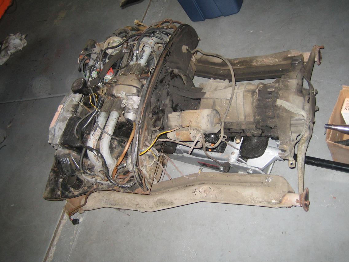

I decided to remove the engine today, I was hoping for help but in the end decided to just do it myself. Could have done with another jack though, the universal joint on the gear shifter linkage could not be disassembled as the grub screw had been rounded by a PO. With the engine bar removed there was just enough room to pull out the whole assembly.
Chris
