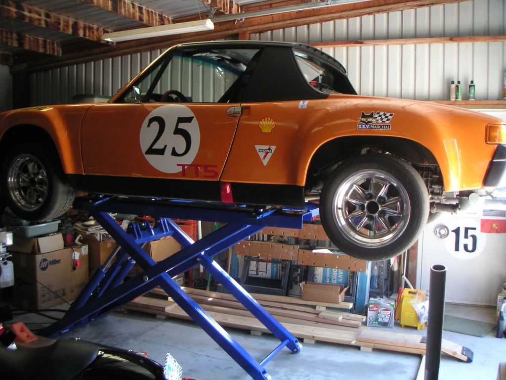

I ended up with the XL6 Midrise lift from Greg Smith Equipment
(IMG:http://www.gregsmithequipment.com/photos/TP-XL6-3.jpg)
Works great with a 914!
Remember that you have to build some ramps to get a 914 over the lift itself
Besides the obvious benefits of having a lift, I recently rebuilt my pedal cluster and boy was it great standing up and just leaning in to R&R the pedals vs. lying on the floor half way in the car doing the same!

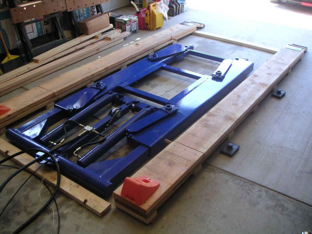

If you notice I have some 'removable' center pieces. They are "on" to get the car onto the ramp (last pic of ramp without the car) and "off" to swing the lift arms out to the jacking points (pic with 914 raised).
I'll get the measurements and post a drawing.

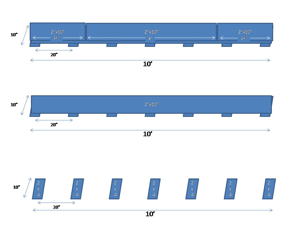

Here's the ramp layout. If I did it again, I would probably just use two 2x4 x 10's instead of the middle 2x10x10. Would be cheaper, lighter and still more than strong enough.
Here's the ramp kit I used.
(IMG:http://www.northerntool.com/images/product/images/33221_lg.gif)
They are overkill but I got tired of messing with an easy way to do this. Without a smooth ramp you end up pushing the ramps instead of driving up them.
Don't let SWW914 fool you. His stuff is awesome! And he does stuff efficiently. I spend twice as much time as needed thinking about it before I do it!! Like drawing pictures of wood ramps instead of just building them (IMG:style_emoticons/default/blink.gif)
