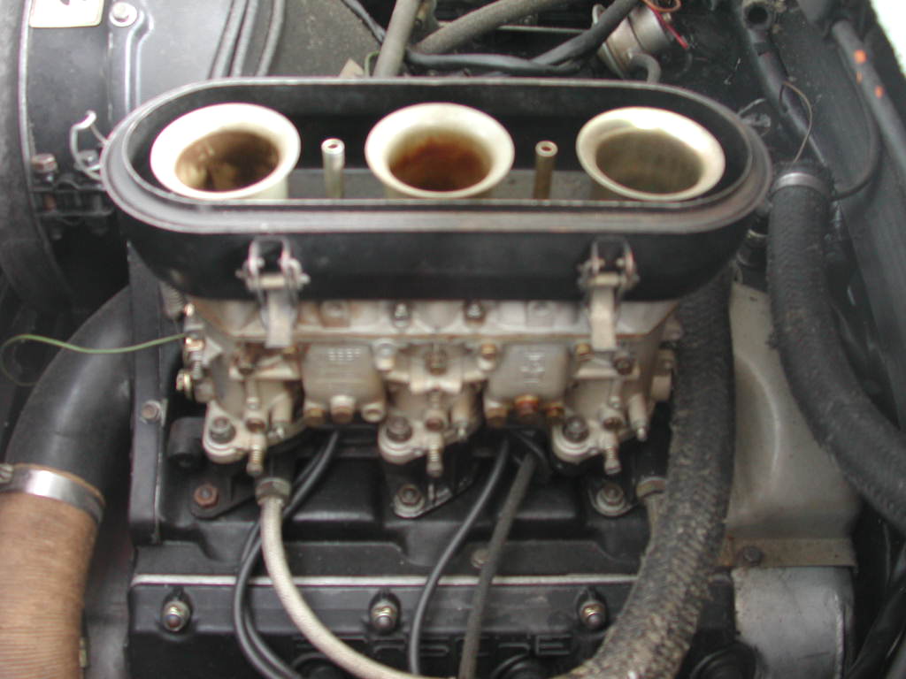

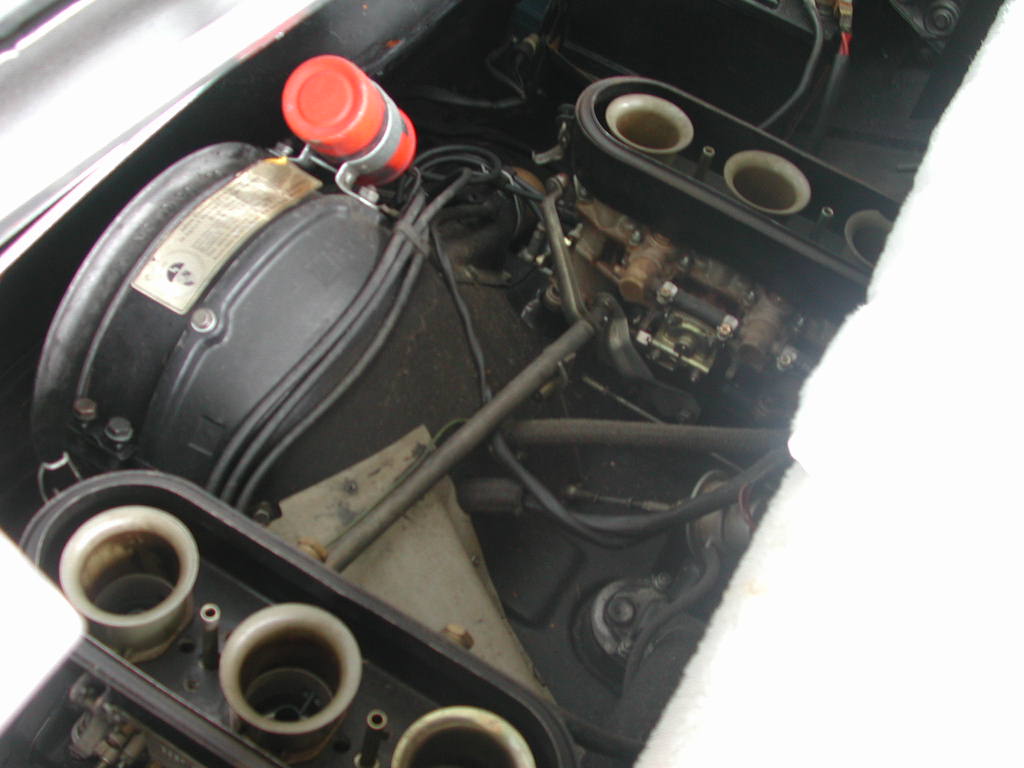

Ok, the alternator is out.
Now we start with the pics.
One at a time, of course.
A couple of opening shots so I can remember what it looked like before I got DWD.
kim.
