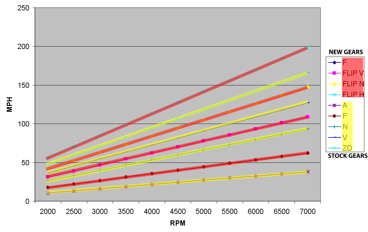

Here is the latest gearbox I am building for someone. It is an F-N-X-HBf box and I wanted to show how easy it is to lock out 1st in a 4 speed box. I have heard that there are people that charge a chunk of change to do the same thing....I think that is wrong as it is way easy. All you need is a rear gasket, tubing cutter and a section of 3/8" copper tubing (1/2" shown as I bought the wrong size).
Here is the FNXHBf stack (Ooo, purdy).
Here is the shift rod end for 1st that needs the sleeve to lock it out. I removed 1st gear completely other than the gear on the input shaft as you need it for reverse.
And here is the section of ~2" copper tubing. You need to keep the slider for revers. It looks like the sleeve will hit the slider, but it is just the angle of the pic. Attached Image

When you guys say that you flipped other gears, what combo do you like best?

When Brad Mayeur did mine, he said it was no big deal, I can see why now.
I have the F- flipV-flipN-flipH setup, can't complain so far. Been running over 400 HP through for a while now. Nothing like hitting 100 in 2nd.

That seems like a tight grouping in the upper gears. Quite a bit of distance between 1 and 2 as well according to my chart.

What tire size are you using in your charts? 245/50?
Dr Evil
post Feb 25 2008, 09:29 PM
Send me your transmission!
Posts: 23,044
Joined: 21-November 03
From: Loveland, OH 45140
Member No.: 1,372
Tire diameter of 25"

So based on this info, with a 26" tire, and a 7k rev limit... we could hit 60 in F gear? on a stock 901?
Dang, I am really short shifting.... Think of the 0-60 times... mid 3's!!

I think mine is a (1st gear delete) tight 1st, second, and third group. Then 4th is a big jump, a flipped H for freeway cruising.
Running errands has never been more fun. (IMG:style_emoticons/default/aktion035.gif)
Dr. Evil, I really like your ratio charts.
Is there a way to tell what gears I have by rotating the input shaft and counting rotations of the output shaft? or visa-versa? I'm curious what my 2 backup trans axles are running.

I would imagine so. The ratio of turns of the input shaft to turns of the output flange will give you a ball park of what you have. I have never tried it, but it may be quite accurate. Give it a shot and post your results and we can figure it out.
the chart that I am using is from Carquips web site. I down loaded it and then I plug in the gears and save the chart. Any combos you want ot see, just let me know and I will post it.
You like the short 1-2-3 and a long drop to 4th? I was under the impression that with the F-N-X-HBf that it would be smoother as the shifting is the same from gear to gear. If the preference is for the shorter 1-3 then I should let my customer know so I can see if he still wants to buy the X gear from me to make the pattern I felt was best.

QUOTE(Andyrew @ Feb 26 2008, 01:37 AM) *
25" wheels. With 26" wheels you will hit 70 faster, if you have the torque to pull it off.

More thoughts. It also depends on your power plant as you all know I am sure. All V8s are not the same. The engine I am building the box for is 200+ hp and peters out at 4200 rpm. So the shift points you get with my set up in this box are about:
-1st shift at 4K gets you to 35mph and 2nd at about 2.3k
-2nd at 4k gets you 63 mph and 3rd at 2.9k
-3rd at 4k gets you 85mph and 4th at 3K
-4th at 4k gets you 115mph with room to go to 183 mph (theoretically)
