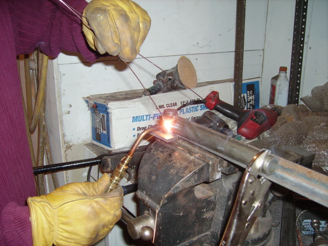

Lots of you guys will know this stuff but some may find it helpful. Here are a couple of photos of a Mercedes I'm working on for a friend. This car was butched back in the 70's. I'm trying to put it back together. All the spot weld flanges are damaged with brazing. The brass needs to be removed and replaced with steel so I can spot weld the car back together.
Some of the flanges are good for the most part, So I'm not cutting them off completely and making new ones. Were I can, I use a piece of copper and simply run a couple beads of weld across the copper and then grind/file the weld back to the thickness of the metal.
Your wire feed will actually arc on the copper. So you can even start your arc just off the edge of the metal your repairing and then move into the damaged edge.
This also works good for a backer on small holes. The copper will pull some of the heat out of the weld causing a rapid cooling effect.
A simple source for copper flatbar is soft copper tubing. If you've done any home plumbing repair you probably have a piece of copper tubing under the work bench. Just hammer it flat and your in business.

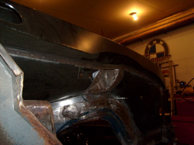

Here's another photo of a repair I had to do. The quarter panel on this car was Brazed to the rear fill panel between the top boot cover and the trunk lid. The brass weld warped the panel bad! There was 1/2" of filler over the repair.
I fit the quarter panel and cut the fill panel back and installed a new attachment for the quarter with a proper step flange. This was butt welded. I used the copper under the weld. It helped draw the heat out and kept the reair area small.

on butt welds that will show, yet you cannot reach around to hold the copper with a clamp...I was thinking.
Can I magnet the copper on there, magnet to magnet...copper and metal in the middle.
Also, I have been using 18 gauge copper...is that thick enough?
Its not really making life easier...so I thought maybe its either not thick enough, or not firmly attached...
Rich

Rich, I like 3/4 " copper tubing. I just cut a length off what ever I think I'll need, hammer it out flat. I would say it's at least 40 ga. because it's double thick. It's rigid enough to clamp and soft enough to trim with a tin snip if you need to notch it out around something.
I would think your 18 ga would try to distort as it pulls the heat way. This would open a gap and allow the metal to drop away. Just a guess.
I've never tried magnets. They would have to be powerful.
You could always use a couple of kleco's or 1/8" sheet metal screws to hold the copper backer in place. Then all you would have left is a couple plug welds when the seam was finished.
You could run the kleco's or sheet metal screws down the seam through the copper backer.

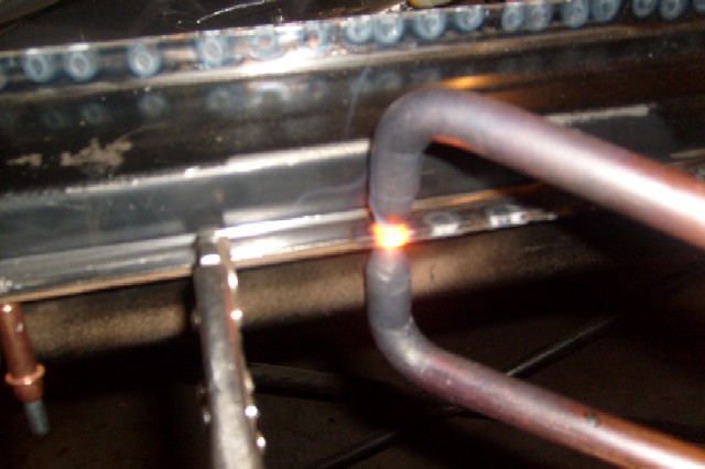

I have a couple fusion welders. One I purchased from Harbor Freight. I use it for doing sub-assemblies. Like this. The second photo is really pushing the welder to it's maximum. The is a rail clamshell. The metal is like 14-16 ga... I'm adding and hiding mig plug welds as a safety. The end results must look factory.

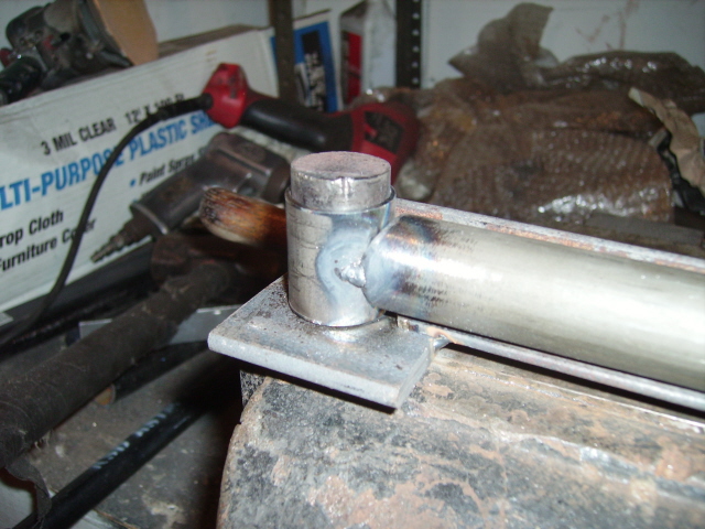

You can make your own anti-sway bars using 4130 thin wall tubing. I did quite a bit of reading about welding the stuff. Lots of guys are tig welding this type of tubing, but the experimental air plane builders are convinced the best method is to gas weld it. And it passes the FAA certification. So if it's good enough for the FAA it's good enough for the Alien. The tig weld looks really nice but cools too quick causing the weld to become brittle. Gas welding will expand the heat out into the tubing a little further and you can control cooling with the torch. Here's a project I have been working on for a while. I hope to have my front and rear bars installed this spring.
Here's the piece tacked in place. Notice I wire brushed the tubing to clean it. Also I chamfered the tube for maximum penetration.

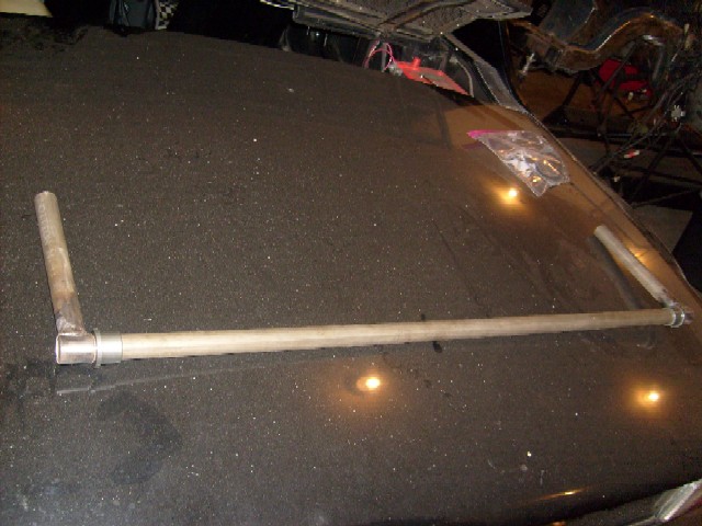

Here I'm welding the 90 deg fitting to the arm while it is clamped in a fixture. The fitting will slide onto the cross bar and get a grade 8 through bolt to secure it.
Here's the bar as it is now. I need to finish this project.
4130 was originally made to be gas welded. I am pretty sure all P-51's were gas welded. Thin tubing is a great use of gas welding - it is not obsolete and should not be discarded as a welding method. I plan to gas weld my steel flares.
