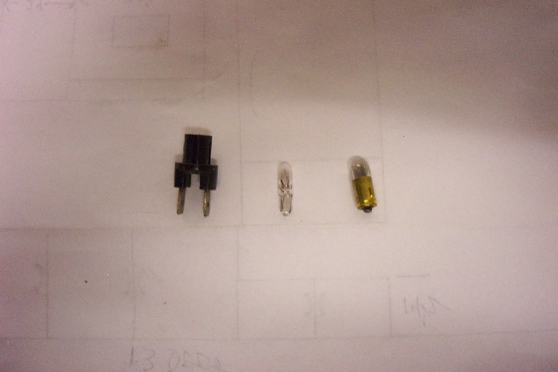

TheCabinetmaker
post Apr 19 2008, 05:55 PM
I drive my car everyday
Posts: 8,339
Joined: 8-May 03
From: Tulsa, Ok.
Member No.: 666
Well, not sure of the specifics of the bulb itself, but I do know they are different.
Bulb on right is standard bulb for all instruments. Bulb on left is alt bulb. It's marked as "osram 12/1.2" On the far left is the holder for the alt bulb.

Cap'n Krusty
post Apr 19 2008, 06:35 PM
Cap'n Krusty
Posts: 10,794
Joined: 24-June 04
From: Santa Maria, CA
Member No.: 2,246
QUOTE(vsg914 @ Apr 19 2008, 10:00 AM) *
Gen light takes it own special bulb. It is not the same as the rest of the dash gauges.
Well, that's a crock. The 911 takes the SAME instrument bulbs as the 914 (given cars of the same era), and the alternator/generator bulb is the SAME as all the other dash light bulbs (with the exception of the little bulb for the heater slide control unit). It's 2 watts. The alternator exciter circuit doesn't work without the bulb, unless someone's kludged up a low amp substitute.
The Cap'n
TheCabinetmaker
