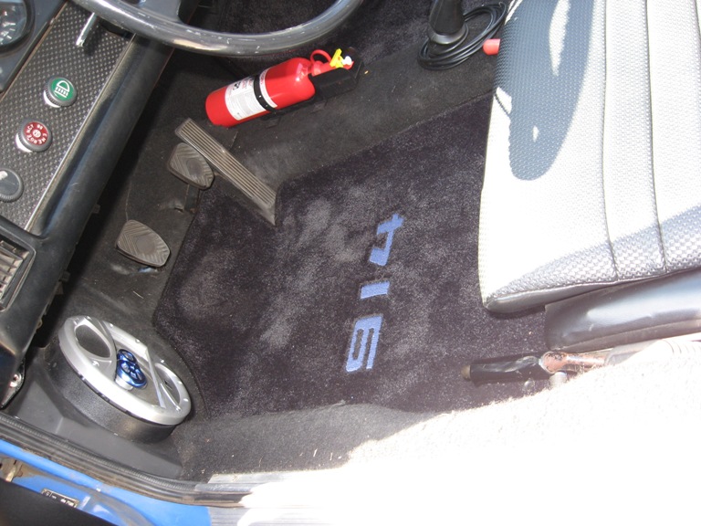

Here is where I put mine. Bought at my local FLAPS - not sure what type but it says it will put out a fire. (IMG:style_emoticons/default/biggrin.gif)
T
