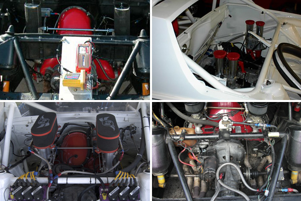

synthesis, 3 of the 4 pics you posted, show the engines with 911 style cooling "tin" or ducting. they ditched the stock and went hi-perf.
East coaster
post Jan 20 2004, 04:54 PM
Posts: 1,856
Joined: 28-March 03
From: Millville, NJ
Member No.: 487
Actually, two of the pics are 911 engines!

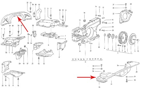

I am thinking in terms of the motor shroud that seals the area between the engine and the chassis.
911 or 914, both cars have it.
The shroud that directs air from the fan over the cylinders and oil cooler of course has to remain. Sorry for not being clear.
I think the parts with the arrows are what I am refering to.

oh. roger that. i thought you were talking about cooling tin (IMG:style_emoticons/default/wink.gif)
