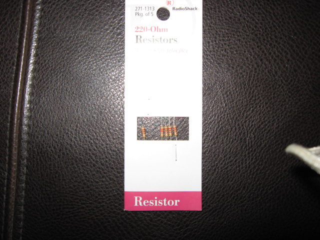

My next step is to try a resistor as suggested above. Here's where my ignorance of things electronic really shows. Asked the guy at Radio Shack for a 1/4 or 1/2 watt 270 ohm ballast resistor. All he had was 220 ohms or 330 ohms. Opted for the 220. Word "ballast" is nowhere to be seen. After investing all of 99 cents for 5, I am thinking I don't have the right component. Before wiring one into the sensor line, thought I should check. So, do I have a resistor that might help? And is 220 too far away from 270 ohms?

Tweaking with resistors is cool and all, but it's off topic. This thing should start and purr flawlessly without having to modify the system. Something else is wrong.
