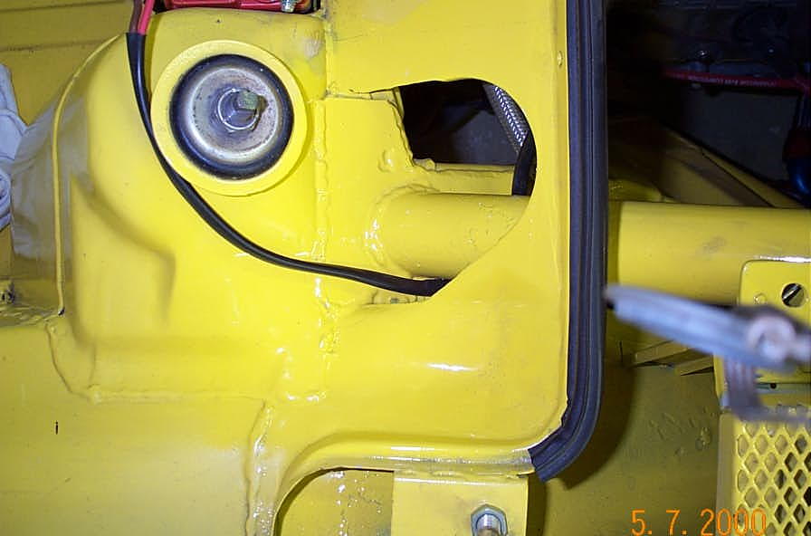

I put some more horsepower in my car, so far I have just autocrossed it on street tires. I have the bolt in roll bar that has the mid bar going to the floor.
Besides that my chassis is stock and I am wondering what I should do for more re-enforcement... so I can comfortably run on slicks.
Below is a photo of the roll bar. I don't consider the roll bar to give to much chassis stiffening, but it just might help with cracking the longs.
Edit: I mainly just use the car for street and the occasional Autocross or DE

I've got a full cage but it's not tied into the shock towers (yet) ...
No other stiffening. I'm running 9" GoodYear R250 slicks. No cracks yet.
