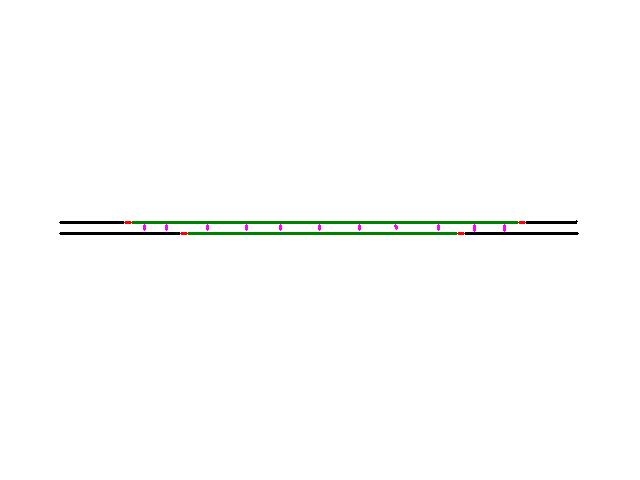

I am doing it differently (an option you didn't list above).
Most of the Hell Hole is double walled. Much of your top layer is rusted out and some of the bottom layer. I would remove 100% of the rust even if this means cutting out more than you would like. Then when you have solid edges, remove about 1" of the top layer but leave the bottom layer (this is tricky, but can be done). This allows the replacements to overlap good metal. Butt weld in the replacement bottom layer. Drill holes in your top layer first (for the plug welds). Clamp in the top layer over the botom and then plug weld first to ensure the top and bottom layers are tight against each others and then I butt weld the edges of the top layer last. Grind it all down and it should look good.
In this image, the black is existing top and bottom layers. The green is the new metal that you fabricate. Both are 20g. The red is the butt welds. The purple is plug/rosette welds. This is much like your option #1, but without a backing plate. If you can't do this, I would then pick option #1

I see what you're getting at in your sketch Richard- I wasn't aware that it was double walled. I may just do it that way now.

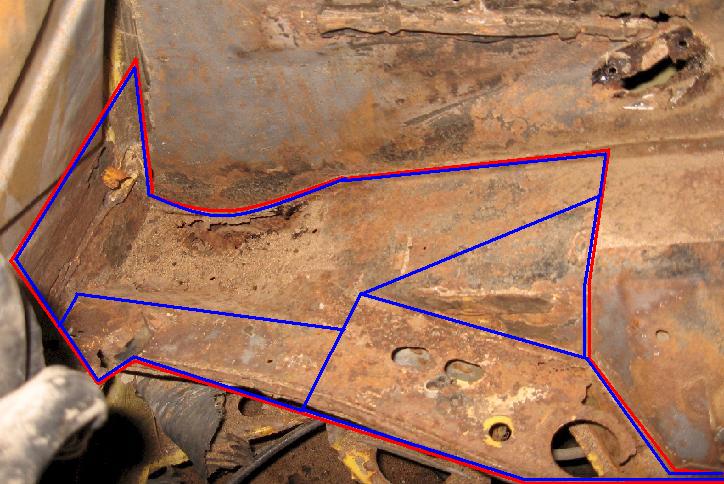

At the same time, I don't expect to cover it all in one big piece. I probably could fabricate it, but I'm not foolish enough to believe that one big chunk is the only way to save time; and it will be easier to form sections. I just meant one chunk of steel for the actual "hole" of the hellhole. Here's a little better breakdown of my plan:
The red denotes the entire section I plan on replacing. The blue is the breakdown of the sections I plan to make. It's just the way Towle made it sound like I should use lots of smaller pieces, which would have taken more time and work.

r_towle
post Oct 7 2008, 11:24 AM
Custom Member
Posts: 24,705
Joined: 9-January 03
From: Taxachusetts
Member No.: 124
The piece going up the firewall should be seperate...trust me.
It should actually be two pieces to retain the flange...its ALOT easier to do it that way.
The added plus is the firewall piece goes in LAST...
You will appreciate doing it that way...
Even with your shoulder hurting...try getting any tool you own in there to cut and grind way in the bottom corner...you cant.
Cut the firewall out, maybe even bigger than you show (save the piece)
Then fix all the rest...
Put the firewall back in as a seperate piece (s) at the end,,,,you will really have an easier time at it...
Rich

Okay, I see what you're getting at now about the firewall Rich. For grinding purposes and such, it would be easier to keep it seperate. Thanks.
