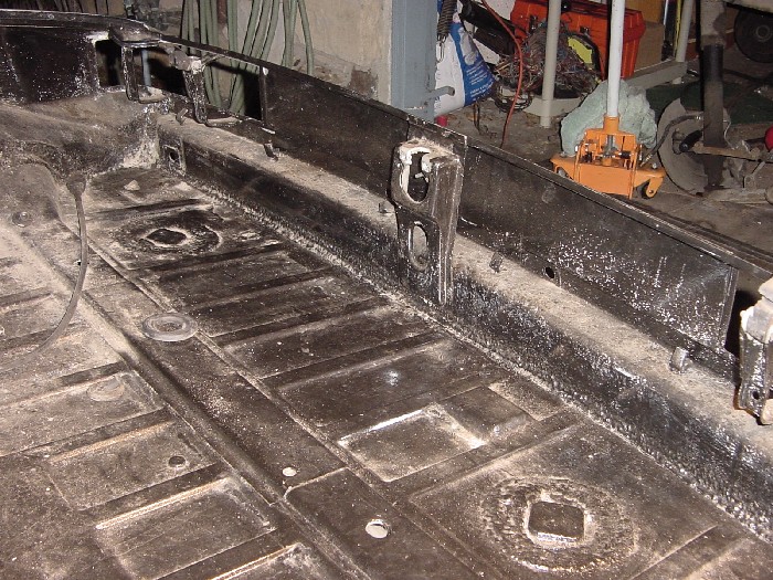

Dusty, but the rear trunk seems to be free of rust bubbles and came POR-15d!

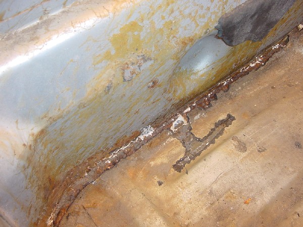

Concerned about the condition of the floorpan, I scraped away a bit of the tar and found clean, primered metal below, with no sign of malignant rust.

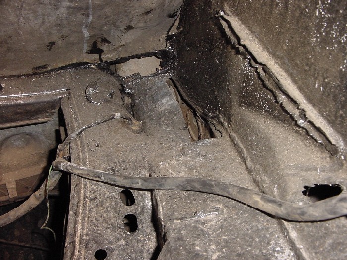

The hell hole needs some work, but it has at least been stabilized by the application of POR15. I'll probably bend up some metal and weld it in, or maybe get a replacement piece.

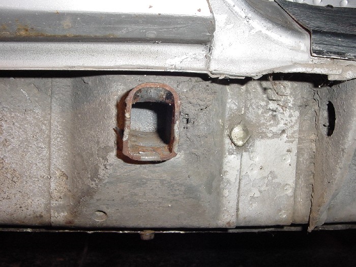

Here's the passneger side jackpost hole. You can see paint on the inside, I take it thats a good sign...

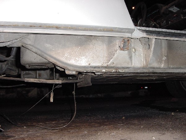

I brushed off the dust from the passenger side long, whacked it with a wrench, poked with a screwdriver and its very solid.

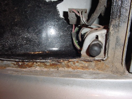

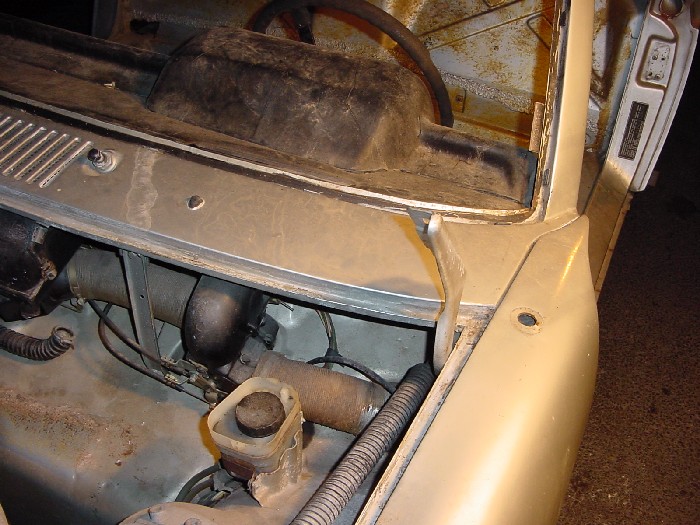

The bad news is here... The piece that holds the weatherstrip in on the front trunk is pretty bad. Luckily it didn't spread into the front trunk, that area seems pristene.

Okay, last picture for now.. The front of the car seems pretty good, this shot shows the fuel tank void, and all the fresh air blower stuff installed and very clean.

Tony, see if someone can give you an idea of how hard it is to patch up the hell hole. I think DNHunt recently did that same area?
From the pics Tony has sent me I am amazed by how good the long is underneath despite the hole up above. Looks like he got to it in time!

I just did that (actually looked exactly like that), Im busy now, but you might find it in the archives.. I took cardboard and cut pieces of carboard to fit, then I cut metal (used an old door for the metal) and then slightly hammered it into the shape that would fit flush and weld good. Mig (if you'll call it that) welded it, and its very strong. Then I welded the battery tray in. All in all looks pretty good (havent cleaned up the underwelds yet..), then I por 15'ed it and painted it. Not that hard, its the prepwork thats a pain.
