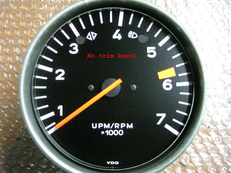

First thing is to open up the gauge. This is done by prying at the bezel with a small screwdriver. Work around ¾ of the circumference of the gauge. It should be possible to remove the front trim bezel holding the lens in place. Beneath the lens is one or two additional bezel trim pieces (depending upon year of gauge).
Examine the rear of the gauge and you should notice 3 or 4 small flat head screws. These hold the gauge mechanism in place. CAREFULLY remove the mechanism by loosening the screws, and set the mechanism aside.

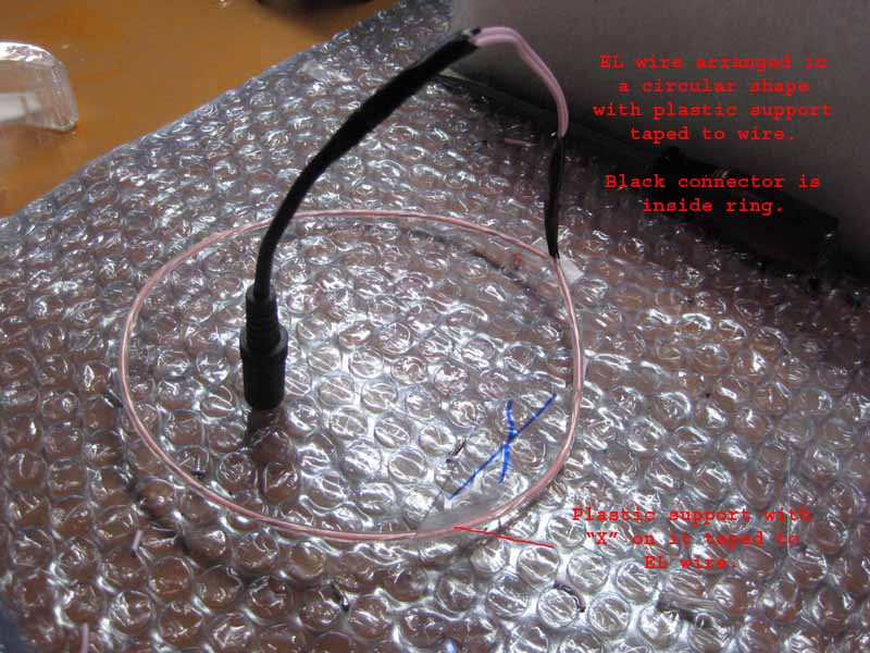

Material Preparation:

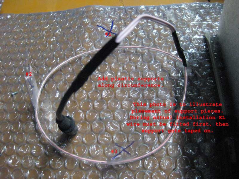

Cut the clear packing plastic into small rectangular strips roughly 3”x2”. Fit to the empty gauge housing and cut to length. Notch one end of the plastic strip to support EL wire. Set aside plastic supports.

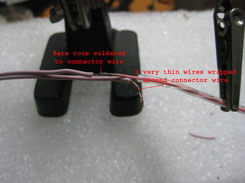

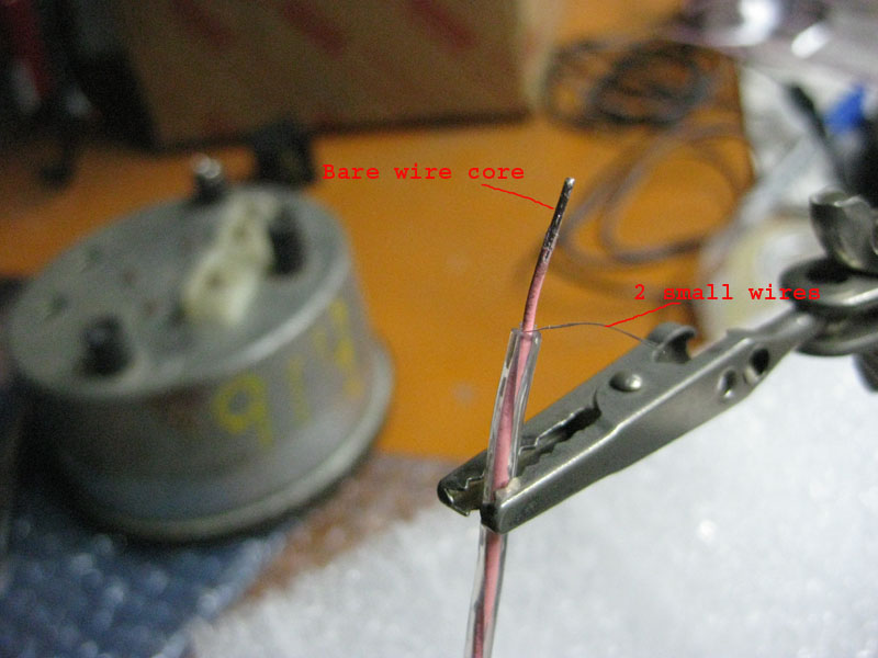

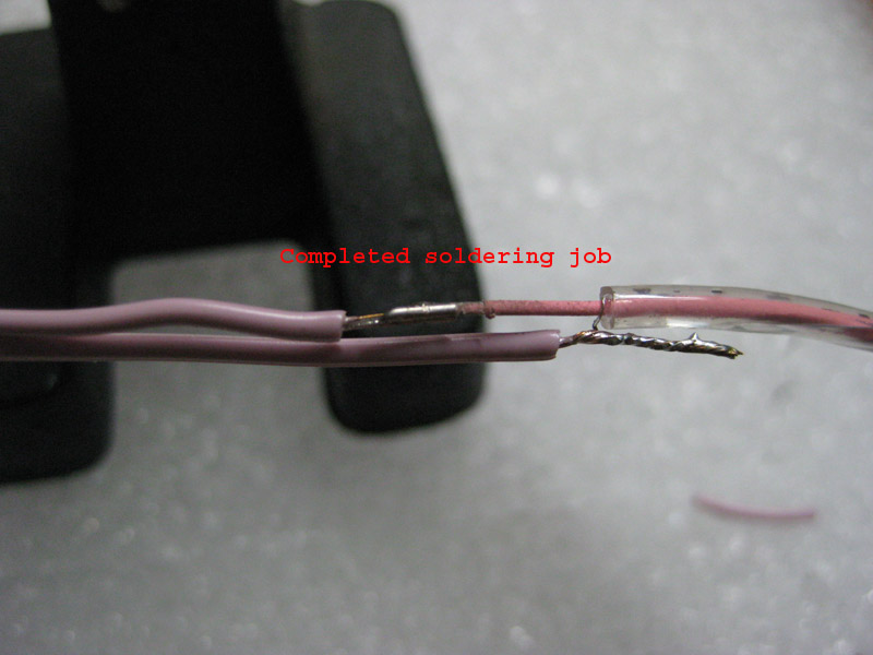

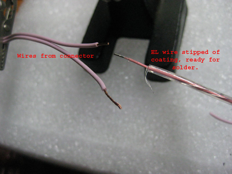

Soldering EL wire:
Strip EL wire. There is a coated core,, and 1 or 2 very small wires. Remove the coating on the core by scratching/stripping/sanding.
Connect wires from connector to EL wire, one wire to bare core, and other wire to the 1 or 2 very small wires.
After assembling inverter outputs, check assembled wire to make sure things light up as expected.

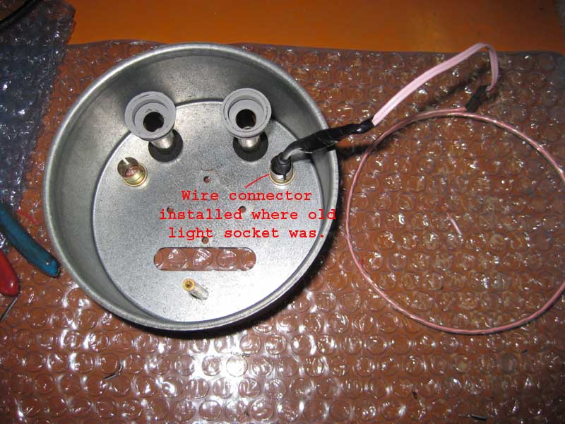

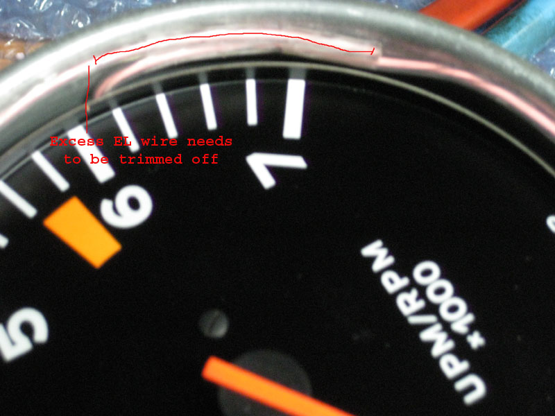

Installation into Gauge:

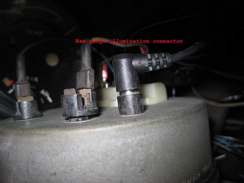

Route EL wire thru the socket originally used for gauge illumination. Position the un-lit
regular wire portion to either top or bottom of the gauge face. Position the EL wire by gently bending it along circumference of gauge. Test fit trim bezel from beneath the lens on the gauge housing. Trim off any overlapping EL wire.
Secure in place by taping wire to plastic support. Use 3 or 4 along the circumference of the gauge. Test fit gauge mechanism back into gauge housing. Insure that no wires interfere with the action of the gauge mechanism.
Hold lens in place over trim bezels and look for EL wire. It should be tucked up nice and tight beneath trim bezel, and should NOT be visible from the side of an assembled gauge

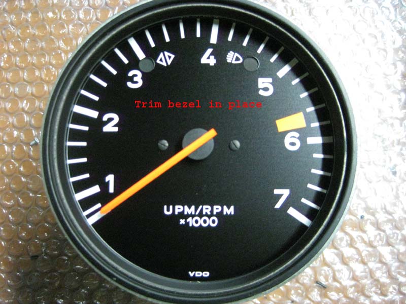

Hold lens in place over trim bezels and look for EL wire. It should be tucked up nice and tight beneath trim bezel, and should NOT be visible from the side of an assembled gauge.
If all things look good, go ahead and re-assemble the gauge, by snapping the outer trim bezel on. Don’t re bend the bezel yet,, we need to test the gauge lighting. After gauge passes lighting test, seal it back up the best you can, by bending over the back of the outer bezel.

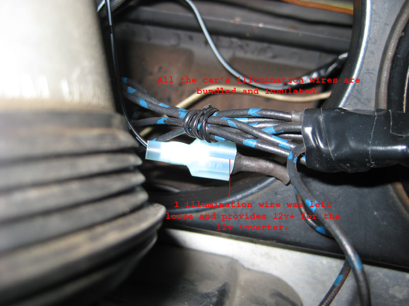

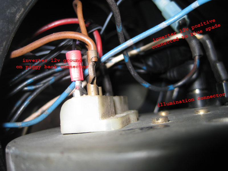

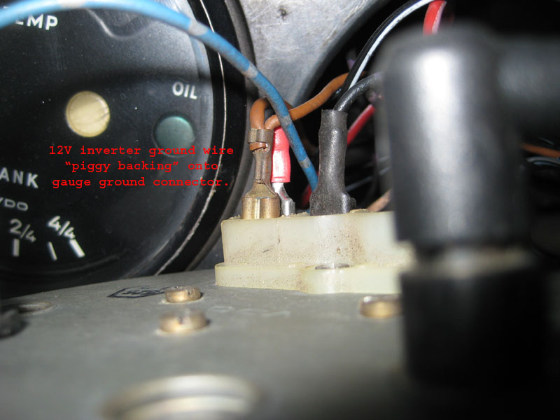

Installation of modded gauges into car:
Disconnect all gauge illumination wires. Black with a Blue tracer in my case. Bundle up all loose ends and leave the very last one free. Insulate the bundled loose ends with black tape. Connect lone free illumination connector to the positive lead of the 12V inverter.
Piggy back the ground connector of the 12V inverter to the ground point of the gauge.
From the 12V inverter there should be a connector wired up for each of the gauges, as well as any additional points that need illumination. Connect each gauge to each connector.
Congratulations, you are done. Flick on the lights and admire your hard work. The gauges illuminates just like a new car.

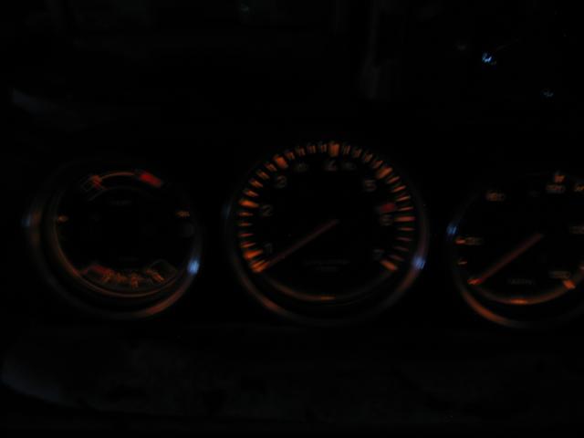

Great idea and it works very well, I used the 5m orange el wire, it fit in the gauges just fine and can't be seen. I used a 3 way pigtail coming off the inverter and its just a quick disconnect to plug or unplug the gauges.
I'm including a pic of the gauges lite up, the picture doesn't do the lighted gauges any justice. The gauges came out great very happy with the results and it was an easy job. Thanks for the thread on how this is done.
