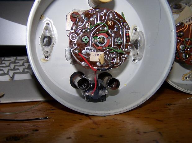

There is a simple fix for the bouncing tach: Add a 2200uF capacitor directly across the windings of the tach needle and you will have a very stable, non-bouncing tach. Here's my installation of the capacitor. Plenty of room in the gauge for the cap. I hot-melt glued the tach in place. Caulking or other thick glue could also be used.

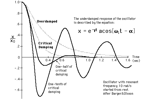

QUOTE(toon1 @ Feb 26 2009, 12:44 PM) *
what causes the bouncy tach.?
The bounce is actually overshoot and undershoot oscillations when revving the engine or shifting. Modern tachs are damped to the point where they do not oscillate when the engine speed changes quickly. Adding a cap to the winding just dampens the response to engine RPM changes. I did this on my 74 and the tach does not bounce or oscillate at all now.
The graph below shows different levels of a damped signal or movement of an arm like the tach needle. In this pic, the movement is from 1 to 0. In a 914 tach, this would be like going from one RPM level to another.
The 914 tach needle oscillates and finally settles to the correct RPM. Adding a capacitor causes the needle to follow one of the damped signals. Too much cap and it is overdamped and slow to respond. Too little cap and it is underdamped and may still oscillate. Critical damping is the goal: fast response w/o oscillations. For 914 tachs, critical damping can be achieved with about 2200uF capacitor.

QUOTE(Spoke @ Feb 26 2009, 03:44 AM) *
Thank you for the information. Would it be possible to point out the places to attach the capacitor. I have never taken the tach out before.
Thanks in Advance.
Ted.
Spoke
post Feb 26 2009, 02:32 PM
Jerry
Posts: 7,425
Joined: 29-October 04
From: Allentown, PA
Member No.: 3,031
The cap connects to the 2 wires from the tach coil. Look at the pic above in post #7. Caps of size 2200uF are usually electrolytic type with a + and - lead.
In the pic, the cap is hot-melt glued in between the turn signal tubes at the bottom of the picture. The red and black wires from the cap connect to the tach coil wires.
In the pic, the positive cap lead goes to the coil side with "+" markings. The coil wires are the little green wires in the center of the tach. I just found a convenient place to add the cap wires (red is + and black is -) and soldered them on.
