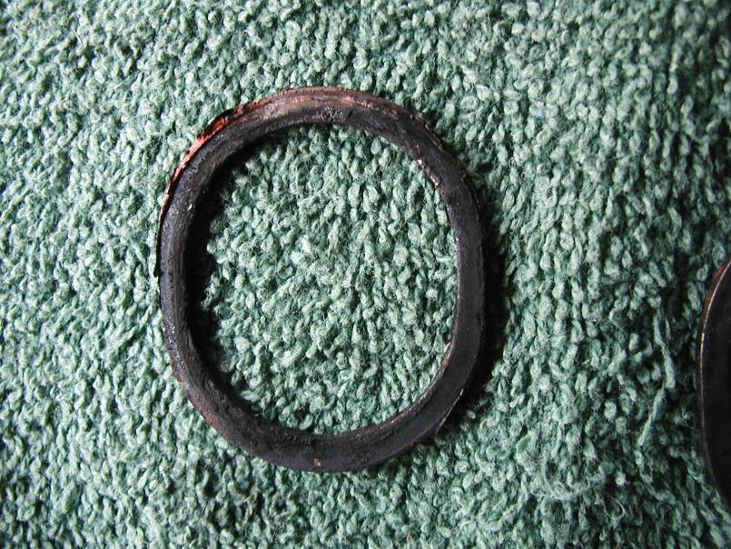

Pulled the HEs today (This could get addictive). It looks like theres blow by on 1,3,4
fitzm1
post Apr 26 2009, 04:40 PM
Posts: 74
Joined: 21-April 08
From: Ballston lake,ny
Member No.: 8,947
QUOTE(Dave_Darling @ Apr 25 2009, 09:17 PM) *
When one of my valve seats did that, it was deformed enough that I had essentially zero compression on that cylinder.
I'm still thinking it's an exhaust leak or something similar, not an internal engine problem.
--DD
Pulled the HEs today (This could get addictive). It looks like theres blow by on 1,3,4. The studs seemed to be tight but the copper gaskets are black. Could this amount of leakage cause the valve lash to sound so loud?
euro911
post Apr 26 2009, 06:40 PM
Posts: 8,937
Joined: 2-December 06
From: So.Cal. & No.AZ (USA)
Member No.: 7,300
I helped a guy remove a leaking exhaust to find the old copper gaskets still seated in the exhaust ports ... in addition to another set someone installed (IMG:style_emoticons/default/blink.gif)
They were hard to see because they were black and jammed in there pretty tight - took a bit of time, patience and special tools to get them out (IMG:style_emoticons/default/chowtime.gif)
... don't know if this applies to your situation or not (IMG:style_emoticons/default/confused24.gif)
