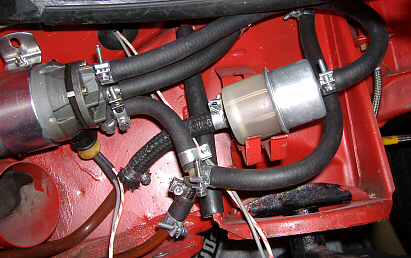

AvalonFal
post Jul 7 2009, 12:25 PM
Posts: 486
Joined: 3-July 05
From: Southern New Jersey Coast
Member No.: 4,367
QUOTE(ericread @ Jul 7 2009, 01:12 PM) *
Maybe this informaiton previously posted by Andy will help:
"S" is suction (from the tank), "D" is Druck or pressure to the FI system and "R" is return (pump bypass if a clog occurs in the engine lines) and is "T"ed to the line from the pressure regulator and then back to the tank.
Here's how I have the pump connected:
Paul

Dave:
See my pic above for the pump connections.
Center port to passenger fuel rail.
Port at relief valve to "Y" to return line to tank.
Top port (away from electrical plug) to fuel filter outlet.
Are all "original" type 3 port pumps configured the same, that is, are the ports are in the same locations? This pump has no ID markings on the 3 ports.

The R port is the one that has the silver "hat" on the side next to it. Your pic says you have that one hooked up right.
The pumps should be set up the same way, because of where the inlet/outlet are relative to the pump rotor. (Brings to mind another question: Has this pump been taken apart? If so, could have been assembled incorrectly. Did that on mine.)
The bypass is a spring-loaded valve. The spring and I think the valve are under that silver cap on the side of the housing. You may be able to take the cap off and free up a stuck valve, but I'm not sure how you get the cap to stay on again afterward.
--DD

I think you're on the right track, Dave. The Chinese pumps are reported to have significant QC issues. While I'm here, I noted in the picture a DEFINITELY substandard non-FI rated fuel filter and the lack of the stepped hose. I can follow up with the correct PN later.
The Cap'n
Cap'n:
The filter was bought from Pelican - part #311-133-511-D-M67. did they send me a bad one?? And yes, the stepped hose is temporarily missing and will be installed when I'm sure this fuel pump mess is finally resolved.
Paul
