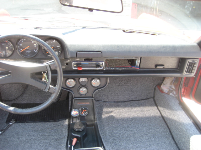

The stock center console gauge came in two setups. They do not have any numeric indication of oil temperature, but rather have a red section at the top of the range which indicates when the motor oil is getting too hot. The red section on the 'early' gauges is larger than on the 'later' gauges. AFAIK, the readout of both gauges is exactly the same, and Porsche redesigned the gauge because owners were nervous/cautious/concerned about the normal operating temperature was 'too close' to the red on the early gauges. These gauges have a 60mm mounting diameter.
An uncommon third gauge replaced the blinking brake warning light in the left hand combo gauge. This sender came in 'silver button' early type and the late 'blank' style. On these gauges the large red warning light was moved to a small red light in the center of the gauge.
VDO Components
Gauge
Upgrading to a VDO oil temp gauge is beneficial because of the numeric representation of oil temp. There are quite a few options for these gauges, but most commonly used are the Cockpit versions which look quite similar to the stock center console gauges. When using these gauges in a stock center console, some modification has to be made to account for the smaller OD of the VDO gauge, since these gauges feature a 52mm mounting diameter. I forget what size, but a section of black ABS pipe can be used to take up the difference perfectly.

The new sender is 'stubby'. I added a picture of it to the original post, as well as a picture of the Cockpit gauge.
The stock gauge should not be used with the aftermarket sender.
The stock sender should not be used with the aftermarket gauge.
