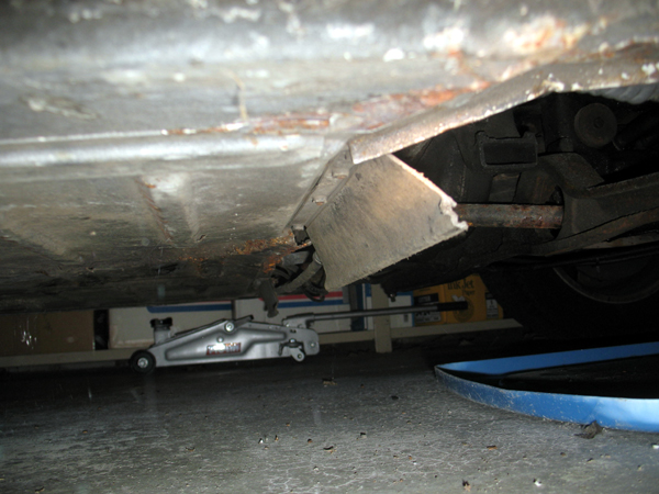

How do the plastic air foils that mount under the car, infront of the engine, help cooling? Are they worth adding?

They were mounted with 3 7mm? bolts on each side. If the car came equipped with them, there should be weld nuts on the rear body pan lip. You can easily drill and use regualar fastners ... no biggie.
As I remember, the are spaced about 15" apart from the centerline of the engine or car (There is a diagram in some manual that I have or try Pelican Parts tech section).
Purpose is to create lo pressure area under the cylinders to help suck air and aid in cooling (they do work well).

jimkelly
post Aug 22 2009, 10:20 AM
Delaware USA
Posts: 4,969
Joined: 5-August 04
From: Delaware, USA
Member No.: 2,460
pic
