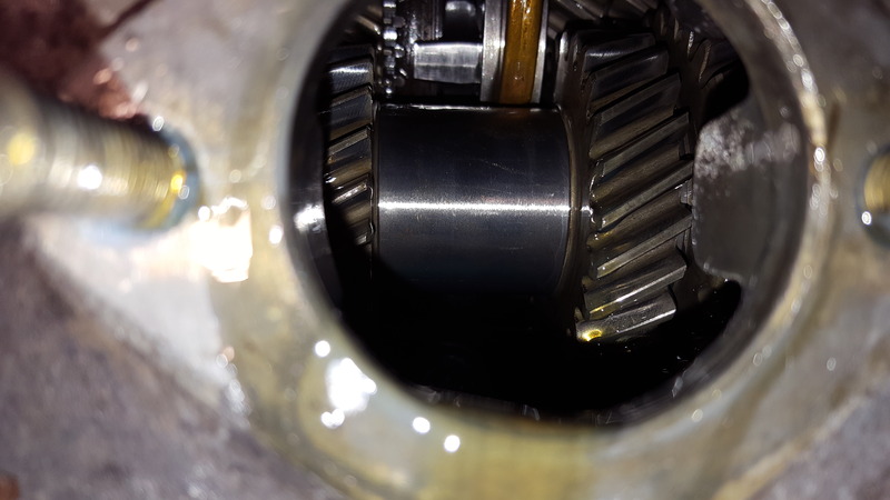

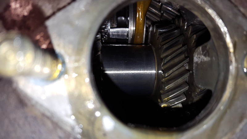

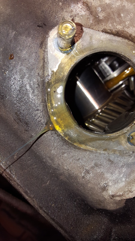

Having the same issue and I'm to figure out to manually put it back in neutral. I removed the console and removed the shift finger. It looks a lot like the pictures below. I will try to upload my pictures tonight.
But I am not sure what to do next. I don't want to start poking around with a screw driver and mess anything up. I was able to move the car but it's still in gear cuz I can hear the engine turn over. Can I put in neutral or do I have to drop the engine?
Thanks in advance. Dave

Here are the pictures of what mine looks like. Anyone know how to put it in neutral manually?
(IMG:http://www.914world.com/bbs2/uploads_offsite/i12.photobucket.com-11800-1479948869.1.jpg)
(IMG:http://www.914world.com/bbs2/uploads_offsite/i12.photobucket.com-11800-1479948869.2.jpg)
(IMG:http://www.914world.com/bbs2/uploads_offsite/i12.photobucket.com-11800-1479948869.3.jpg)

Slide the brass shift fork (top center of first photo) to the left.
It will be in neutral when you can see equal parts of that shiny horizontal "shield-shaped" thing mid picture on either side of the shift fork.
