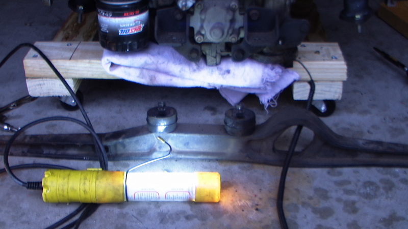

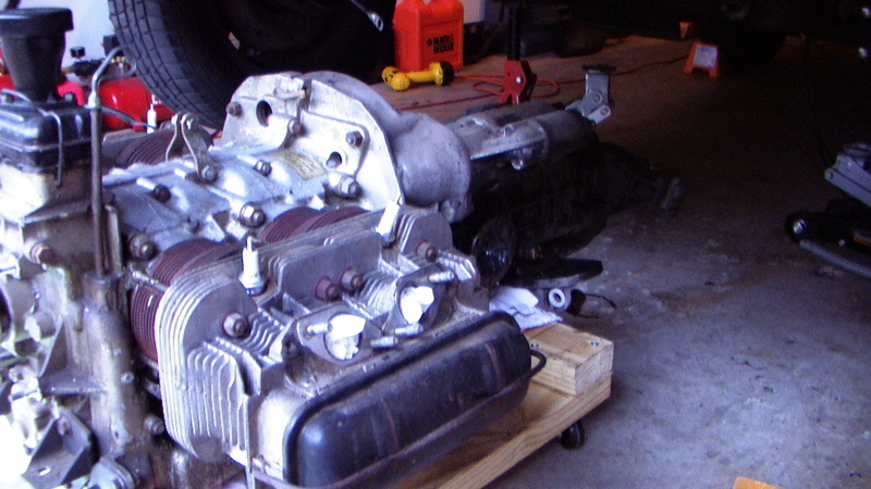

I did mine really ghetto... and by myself
I put the car on jackstands, of course, as high as it can go. took the induction off the top of the engine first, so it clears the rear valence.
then i built a square dolly out of a 2x4 and 4 heavy casters.
used 2 floor jacks, one at the engine mount bar, 1 at the tranny rear. lowered front down, lowered back down. rolled it out.
easy.
Getting it back in was not
