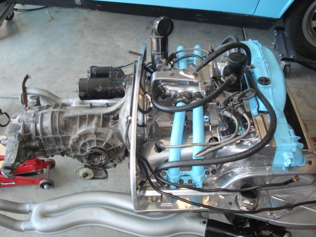

It's been awhille since I've added anything to the thread.
The engine is finally done! I took the tranny apart also. I was having a hard time shifting from 1st to 2nd. I replaced the 1st gear syncro ring, also the 2nd to third syncro and slider. there was a leak in the front main so I replaced that also.
Here is the tranny and engine together ready for install.
